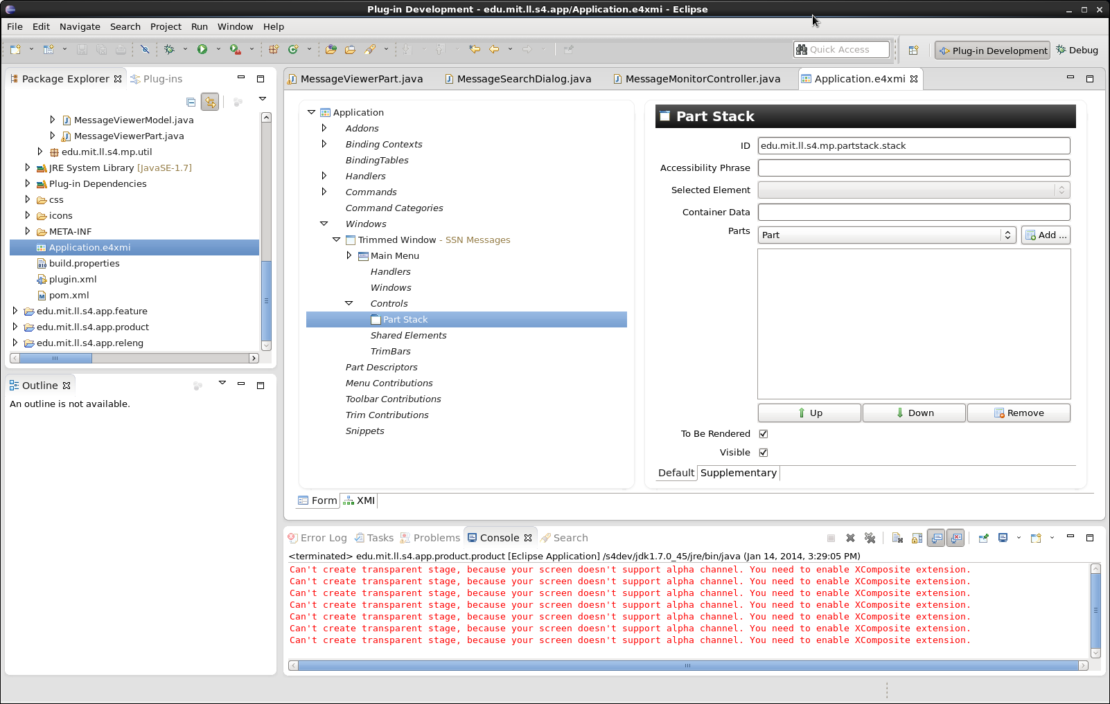

I'm developing an E4 application which consists of a TrimmedWindow with a menu and part stack. The part stack currently has no content and a part is added to the stack based upon a menu choice. The menu command/handler calls a controller which configures a part and adds it to the part stack. This has been working very well so far.
One thing to note, however, is that app window initially comes up empty (no parts) and the user must select a menu choice to populate the window with a part. I want to set it up so that when the app is opened, a specific part (with a specific configuration) will be opened automatically by default. I'm not sure of the correct way to do that in the context of how I'm currently managing my parts.
Code exmaples follow that show some of what I'm doing.
The handler associated with the command attached to the menu choice to configure a "monitor" part to display inbound and outbound message traffic: (The is the configuration I'd like to have come up automatically when the app opens.)
