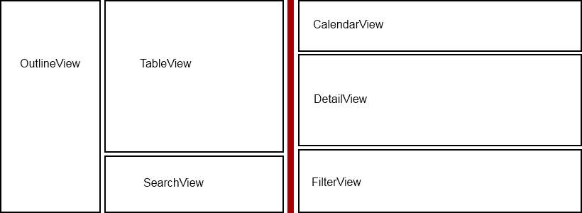

I'm familiar with the scout concept of using different outlines depending on context.
I've also managed to add additional views and/or view stacks to the existing views using the org.eclipse.ui.views extension point in an SWT client's plugin.xml file.
However, I'm not quite sure what the best way to tackle the following requirement is:
In our application we want to have to different layouts depending on what type of data we are working with. In "mode 1" we want to use a layout as shown to the left of the red bar (i.e. the classic scout layout with OutlineTree, TablePages and SearchPages). In "mode 2" we want to use a layout as shwon to the right of the red bar (i.e. no OutlineTree and three separate views).
index.php/fa/17169/0/
One approach I've been considering is to define those six views in the one default perspective that is created by the scout SDK. Basically, the three views shown on the right would overlap the three views shown on the left and when switching between the two modes, we would show/hide the corresponding views.

My question is: How do I hide/end such a form()
The other approach - of which I'm not sure if it is supported by Scout - would be to define two different perspectives in the plugin.xml file (one for mode1 and another for mode2). I could then define the three views for the first perspective and the three views for the second perspective.
Is this feasible/supported with Scout?
If yes, how would I switch between the perspectives? What would I need to take care of with regard to the currently shown forms/views before switching to the other perspective?

Both approaches should work.
Approach 1:
To hide a form just call ClientJob.getCurrentSession().getDesktop().removeForm(form);
The state of the fields won't be touched so you can reshow it any time later.
Btw: To hide the outline table form you may use desktop.setOutlineTableFormVisible, which in fact does nothing more than add / remove.
