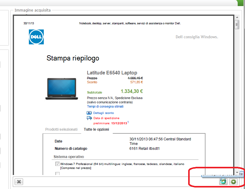

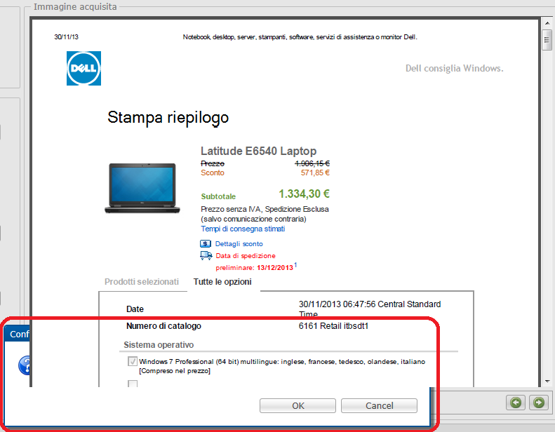

However we are encountering a very strange problem, which is showing up just with PDF files (PNG or JPEG do not show this problem). It seems that every time a PDF is opened in this way, any Dialog or Hint (on mouse hover) goes 'under' (z-index) the PDF itself.
I am attaching images for showing the effect.
Any suggestion for solving this issue?

It's indeed very annoying and it reach its worst behaviour when the dialog pops up completely under the pdf, so, being modal, the entire application is just frozen!
