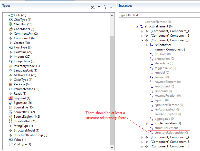

I have another question about the StructureModel. I have populated my structure model with components and I created and saved the 9 structure relationships between these components. However, when i open my KDM representation with the MoDisco browser, i see the 9 structure relationships among the Types but i do not see these relationships among the Instances of my segment (in the tree viewer). I have attached a file to illustrate my problem. Below are the main instructions i use to create a structure relationship between two components. Could you help me figure out what is wrong with my code?

Re: How can i persist a new created KDM model? [message #1222357 is a reply to message #1222202] Fri, 20 December 2013 03:27 Go to previous messageGo to next message
It seems you are not adding the outgoingRelations to the correct element in the model.
You have to add these elements to the structureRelationship property of a Component model element.
Adding them at the root of the model (this is what you are doing when calling to resourceModel.getContents()) is not correct.
Re: How can i persist a new created KDM model? [message #1222457 is a reply to message #1222357] Fri, 20 December 2013 08:29 Go to previous message
Thank you so much for your help. I deleted the instruction resourceModel.getContents().add(structureRelation); and i directly added the structure relationship to the start component as follow and it worked Smile
