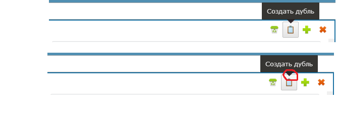

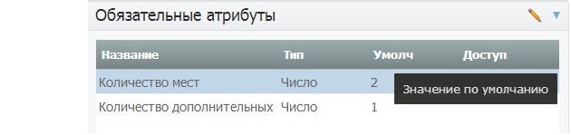

Hi, in our RAP 2.2 application ToolTip down don't show background image. Left/Right/Up work correctly.
My browser Google Chrome. For more detail's see attached files.

Hi Anatoly,
the down arrow will be missing only if the tooltip points to partly
visible widget. In this case the tooltip behaves as before - no arrow
and positioned on mouse pointer. See:
422265: [Tree][Table] Cell tooltip position is wrong when column is
partly visible
https://bugs.eclipse.org/bugs/show_bug.cgi?id=422265
