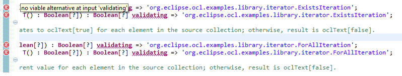

I have cloned the ocl repository and when i open "OCL-2.5.oclstdlib" it contains few error at "validating" keyword. The error text is "no viable alternative at input 'validating'". Can you please explain why it is so? and how i can solve this?
if i remove "validating" keywords then there is no error.

You are not using consistent tooling.
The 'validating' keyword was introduced by
commit 3c715ddb11d8f316ec9e8748423204d85f1ca594 on 2012-11-28 15:54:04
to identify non-strict library functions that could turn invalid into
non-invalid.
You must use an OCLstdlib editor later than that. e.g. Kepler.
Ed Willink

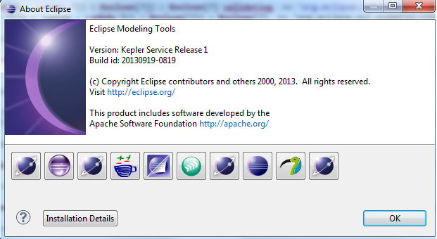

I am using kepler. I am also trying to do updates using "http://download.eclipse.org/releases/kepler" and it says no update found...
index.php/fa/17013/0/
Can you please explain which plugin needs to updated and from where(URL)?
thanks for the help!
  • Attachment: kepler.png
    (Size: 79.27KB, Downloaded 1578 times)
Re: OCL standard library error : no viable alternative at input 'validating' [message #1220556 is a reply to message #1220522] Thu, 12 December 2013 09:20 Go to previous messageGo to next message
HI
Ah! But the support for validating iterations was added by
commit 7f7a2b6b6533e6901b54b90a76dfc8ee514f04ad on 2013-09-05 12:39:55
so you need to install the Luna M2 or M3 milestones (or M4 Monday).
THese can be installed on Kepler.
Ed Willink
