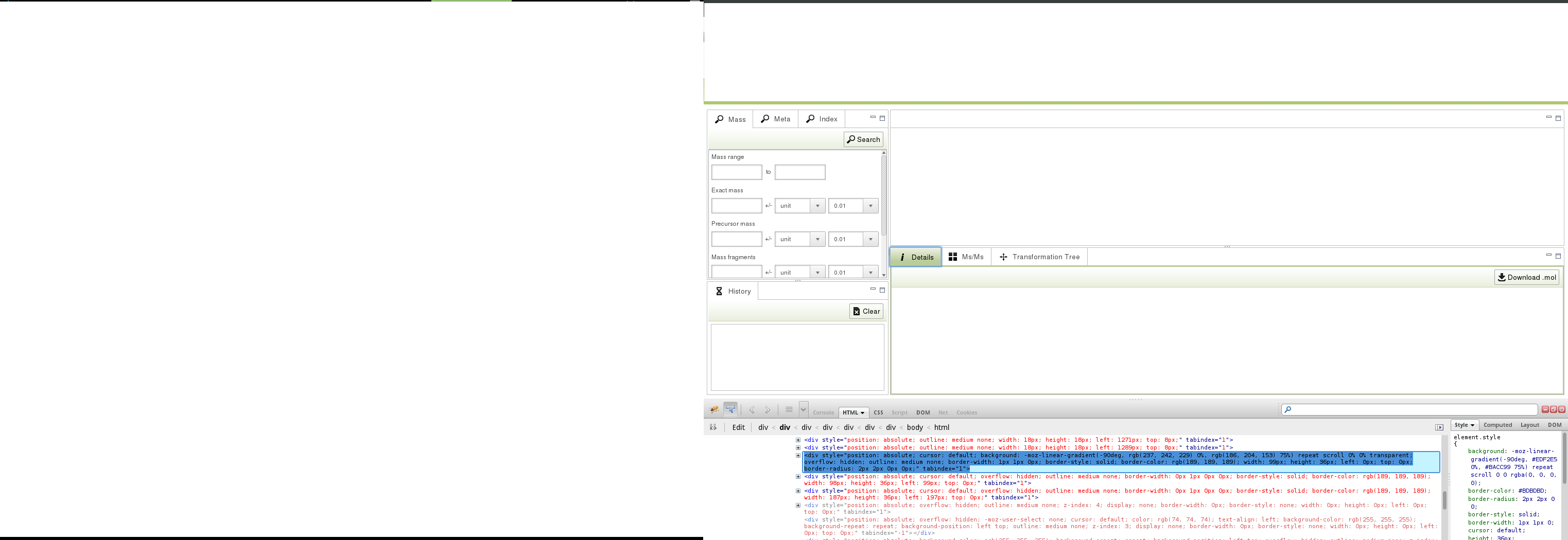

In one of my Workbench Perspective i have 7 views. 4 one the left side, 3 at the bottom.
Sometimes (about 50% of the time) the right views are only clickable with the right Mouse Button, meaning the Application is unusable
I have attached two screenshots showing Firebug when the view is clickable or not.
It first occurred when i was adding a fourth Combo Viewer to the "Mass" View on the left and it happened again yesterday as I added the History view (bottom left)

  • Attachment: working.png
    (Size: 108.75KB, Downloaded 213 times)
  • Attachment: notWorking.png
    (Size: 101.40KB, Downloaded 215 times)
