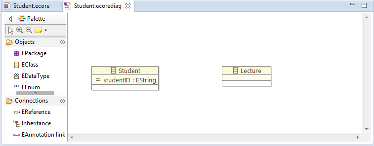

Hi all,
I am trying to programmatically create a connection(an EReference) between two EClass on a GMF-based Editor. (cf. picture - an ERefference bewteen the Student and the Lecture)
I tried using CreateConnectionRequest, codes are as followed:
CreateConnectionRequest createConnectionReques = new CreateConnectionRequest();
createConnectionReques.setSourceEditPart(sourceEditPart);
createConnectionReques.setTargetEditPart(targetEditPart);
Command commandConnection = sourceEditPart.getCommand(createConnectionReques);
if(commandConnection.canExecute()){
    commandConnection.execute();
but a NullPointerException for the command is thrown, that means the command is not initiated correctly. I really don't know why Sad .
Could anyone help, how to build the command correctly?
Thanks in advance.
