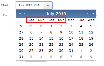

I attached picture with the problem. I tried to change locale but this problem occurs in every language.

You mean DateTime constructor. Locale is en_GB. It takes it from browser settings.
weekdayNames: [, Sunday, Monday, Tuesday, Wednesday, Thursday, Friday, Saturday]
weekdayShortNames: [, Sun, Mon, Tue, Wed, Thu, Fri, Sat]
Calendar days are shown incorrectly for some months, not all.
For example: 07.2013, 09.2014, 12.2014

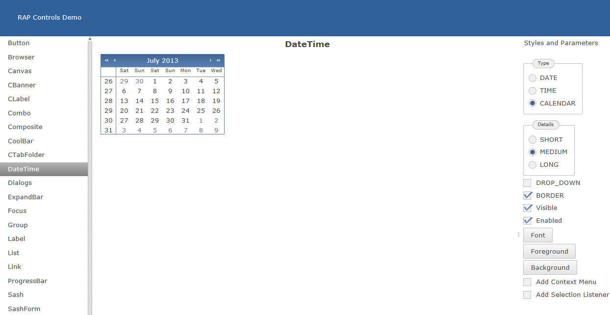

Yes same problem on demo page (screenshot attached).
1) Open link with IE 10
2) In Internet Options -> Languages -> set language "English (United Kingdom) [en-GB]"
3) Set type to "CALENDAR" and go to July 2013
  • Attachment: rap.PNG
    (Size: 43.97KB, Downloaded 249 times)

Re: Calendar in some months shows wrong weekdays (only in IE) [message #1219500 is a reply to message #1219498] Wed, 04 December 2013 04:45 Go to previous messageGo to next message
Reproduced for IE11 for WIN7
Re: Calendar in some months shows wrong weekdays (only in IE) [message #1219502 is a reply to message #1219498] Wed, 04 December 2013 05:11 Go to previous message
Opened bug https://bugs.eclipse.org/bugs/show_bug.cgi?id=423160
