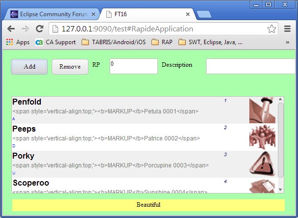

Markup doesn't seem to be support when using rowTemplates in Tables... is this supposed to work? I thought I read somewhere the Markup could still be used even with rowTemplates?
Example Table showing how HTML is not being rendered:
index.php/fa/16863/0/
with:
table.setData(RWT.MARKUP_ENABLED, enabled);
Thanks, John

It's working fine for me. Are you sure that you set both ROW_TEMPLATE
and MARKUP_ENABLED directly after creating the widget?
Greetings,
Tim

Re: rowTemplates and MarkUp [message #1214359 is a reply to message #1214332] Wed, 27 November 2013 12:10 Go to previous messageGo to next message
How 'DIRECTLY AFTER' does it need to be done?
I'm certainly doing it before the UI thread lets go.
There's a bit of processing in between, such as creating the columns etc.
Presumably you cannot set the Table's Template until you've created all of the columns?
If it makes a difference, I'm using RWT from 20131111... might it have been fixed since then?
Re: rowTemplates and MarkUp [message #1214777 is a reply to message #1214359] Wed, 27 November 2013 16:12 Go to previous messageGo to next message
Hi.
Within the createUi/createContents method (using EntryPoint API).
> of the columns?
Nah, you can do that in any order.
That's probably it.
Tim Buschtöns
Twitter: @EclipseRAP
Re: rowTemplates and MarkUp [message #1216041 is a reply to message #1214777] Thu, 28 November 2013 04:49 Go to previous messageGo to next message
So you think it is the RAP version?
Trouble is, I need a Tabris version, rather than plain RAP, so need to wait until those changes have made it into Tabris...?
Re: rowTemplates and MarkUp [message #1216115 is a reply to message #1216041] Thu, 28 November 2013 05:21 Go to previous messageGo to next message
Hi John,
unfortunately, the Tabris clients don't support markup yet. Processing
markup is not that simple on mobile platforms, but I've heard with new
iOS versions, that there is a chance to support at least basic textual
markup.
Cheers,
Ralf

Re: rowTemplates and MarkUp [message #1216125 is a reply to message #1216115] Thu, 28 November 2013 05:28 Go to previous message
Hi Ralf,
Yes, I understand... our runtime distinguishes between mobile vs browser at runtime, so uses markup on browser only, but it does mean we need a common RWT/RAP as the same appserver needs to support both types of platforms.
Fortunately, I noticed that Tabris server adopted RAP 2.2 RC1 yesterday, so just downloaded this plus the latest nightly of RAP, and the combination seems to work very well. Certainly I now have markup with rowTemplates.
Great stuff!
Cheers, John
