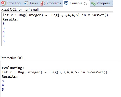

Bag->asSet() operation does not return the set with unique elements
let x : Bag(Integer) = Bag{3,3,4,4,5} in x->asSet()
if i execute the above query in "interactive xtext OCL" console i get "3,3,4,4,5" but if i execute it in "interactive OCL" then i get the correct result.
It seems a bug in pivot/xtext imlpementation.
Please check the image.
index.php/fa/16853/0/
  • Attachment: bag.jpg
    (Size: 28.47KB, Downloaded 607 times)

Indeed. Fixed by commit 551890f69da19012696b2dae780646c6c7e5430b on
2013-10-27 13:36:44
so if you use the Luna M3 install you should be good.
Ed Willink

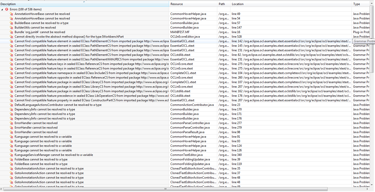

I have cloned the repository from git://git.eclipse.org/gitroot/ocl/org.eclipse.ocl.git (Master). It gives me many build errors.
what is problem in my case?
index.php/fa/16990/0/

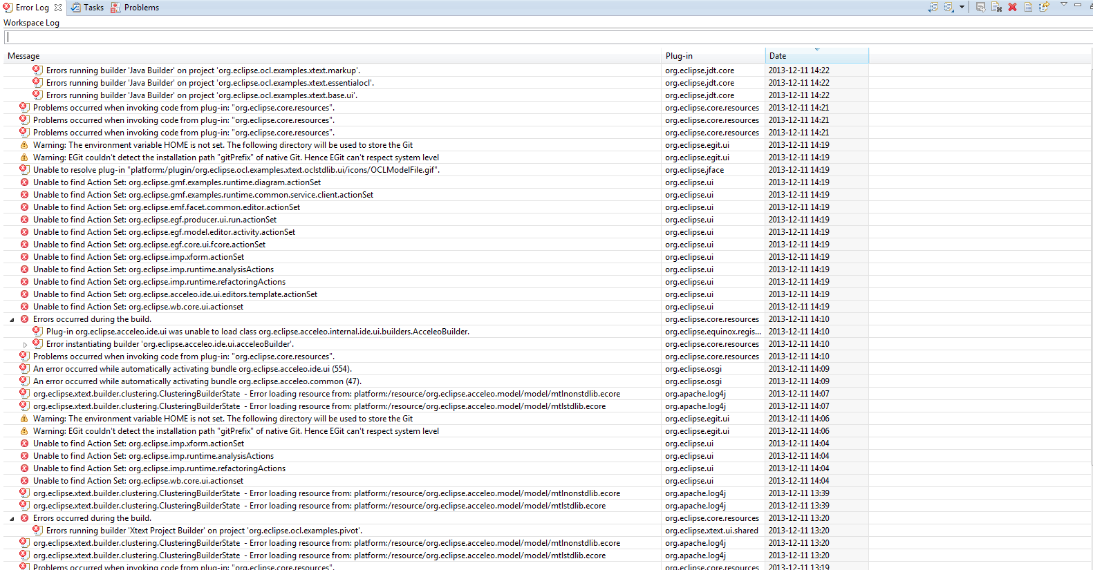

I have downloaded the latest version of Eclipse with modeling tools and i am getting the folloing error message when i build the workspace having ocl git repository clone.
Errors occurred during the build.
Errors running builder 'Java Builder' on project 'org.eclipse.ocl.examples.xtext.base.ui'.
Errors running builder 'Java Builder' on project 'org.eclipse.ocl.examples.xtext.essentialocl'.
Errors running builder 'Java Builder' on project 'org.eclipse.ocl.examples.xtext.markup'.
index.php/fa/16991/0/

I have solved most of the errors.
I am having an error at class declaration of org.eclipse.ocl.examples.editor.ocl.ui.OCLCreationFactory
Multiple markers at this line
- The return types are incompatible for the inherited methods
ICreationFactory.createNodeLocator(ICSTRootEnvironment<?,?,?,?,?,?,?,?,?,?,?,?>),
AbstractCreationFactory.createNodeLocator(ICSTRootEnvironment<?,?,?,?,?,?,?,?,?,?,?,?>)
- The return types are incompatible for the inherited methods ICreationFactory.getLanguage(),
AbstractCreationFactory.getLanguage()
- The type OCLCreationFactory must implement the inherited abstract method
ICreationFactory.createNodeLocator(ICSTRootEnvironment)
ICreationFactory.createSourcePositionLocator(ICSTRootEnvironment)
- The type OCLCreationFactory must implement the inherited abstract method ICreationFactory.getAdapter(Class)
any idea?

I updated
http://wiki.eclipse.org/OCL/Dev/Setup#Getting_the_Sources_from_GIT a few
days ago.
http://eclipse.org/modeling/mdt/ocl/resources/ocl.psf should get what
you need and avoid pulling in obsolete plugins from archive that have
correspondingly obsolete dependencies.
Ed Willink

Re: bag-&amp;amp;gt;asSet() operation bug [message #1220491 is a reply to message #1220401] Thu, 12 December 2013 02:46 Go to previous message
Apologies. I didn't do a very good job of updating. The "Engage" tab of
http://projects.eclipse.org/projects/modeling.mdt.ocl now displays a
variety of team project set files, of which
http://git.eclipse.org/c/ocl/org.eclipse.ocl.git/plain/releng/org.eclipse.ocl.releng/psfs/ocl-all.psf?h=master
is the correct one to install everything that is needed. (It is now in
the main OCL GIT rather than the anciliary MDT pages.)
Ed Willink
