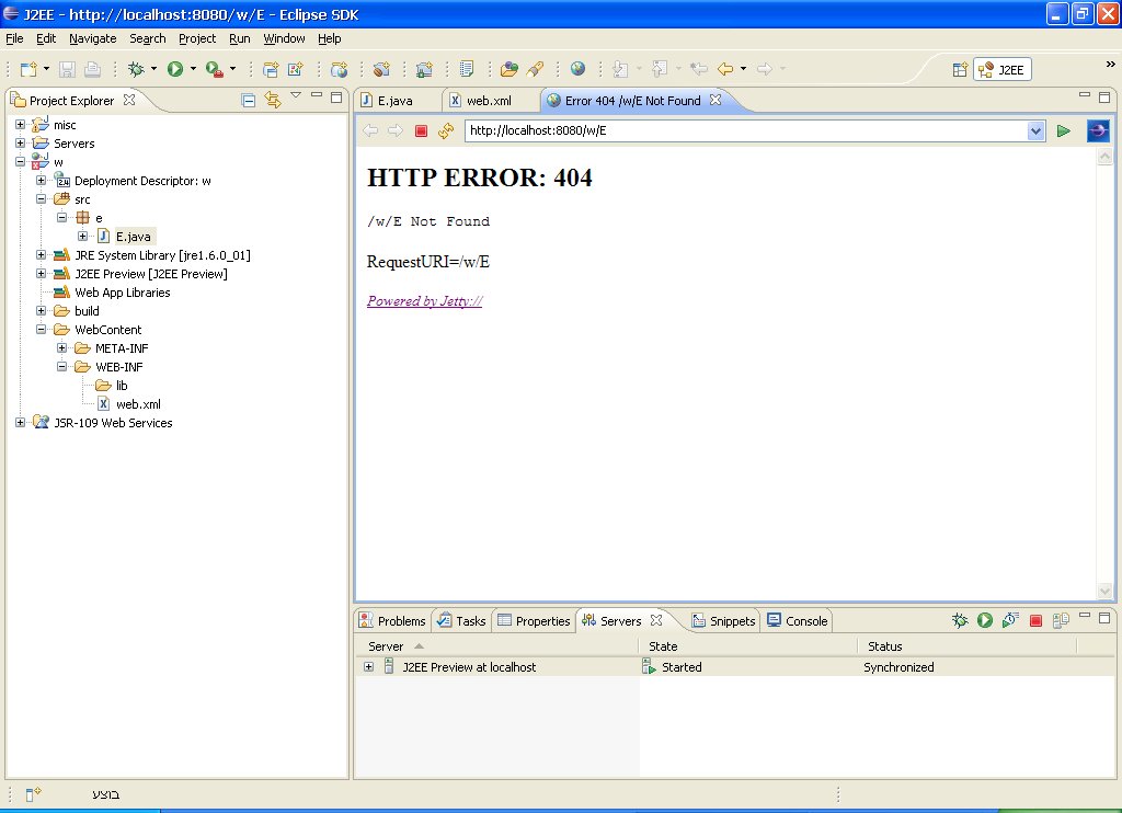

hi,
I am creating a simple dynamic web project,
and for some reason, when i starts the server
& try to access by url a simple servelet, I receive an http 404 error. (at
any browser)
(this error means that the server is accessible, but the specific resource
at the server is not accessible).
this happens when i use tomcat sever and when i use "J2ee preview server" or
any other.

Originally posted by: tauberg.013.net
I may add, that it also happens with jsp files.
& I have a jre1.6.
& it happens also when i set the project facet to java6.
& i done this and it still happens:
at a new computer i download&install jre1.6
i download&install eclipse
i download&install wtp
i created a dynamic web project using the wizard
& stiil getting this 404 error.
my project is attached
"david" <tauberg@013.net>
  • Attachment: f.rar

I tried your files using a new workspace with Tomcat 5.5 and the J2EE
Preview server and everything worked as expected. It's not clear what
is different about your workspace that is causing this behavior. Is
there anything in the console log that might give a clue?

hi thank you!
you have also answered me at the :
http://www.nabble.com/Why-does-i-receive-ah-http-404-error-t f3896399.html
i slove this like that:
i downloaded eclipse for jee developers from :
http://www.eclipse.org/downloads/
& run the project.
& now it works!
