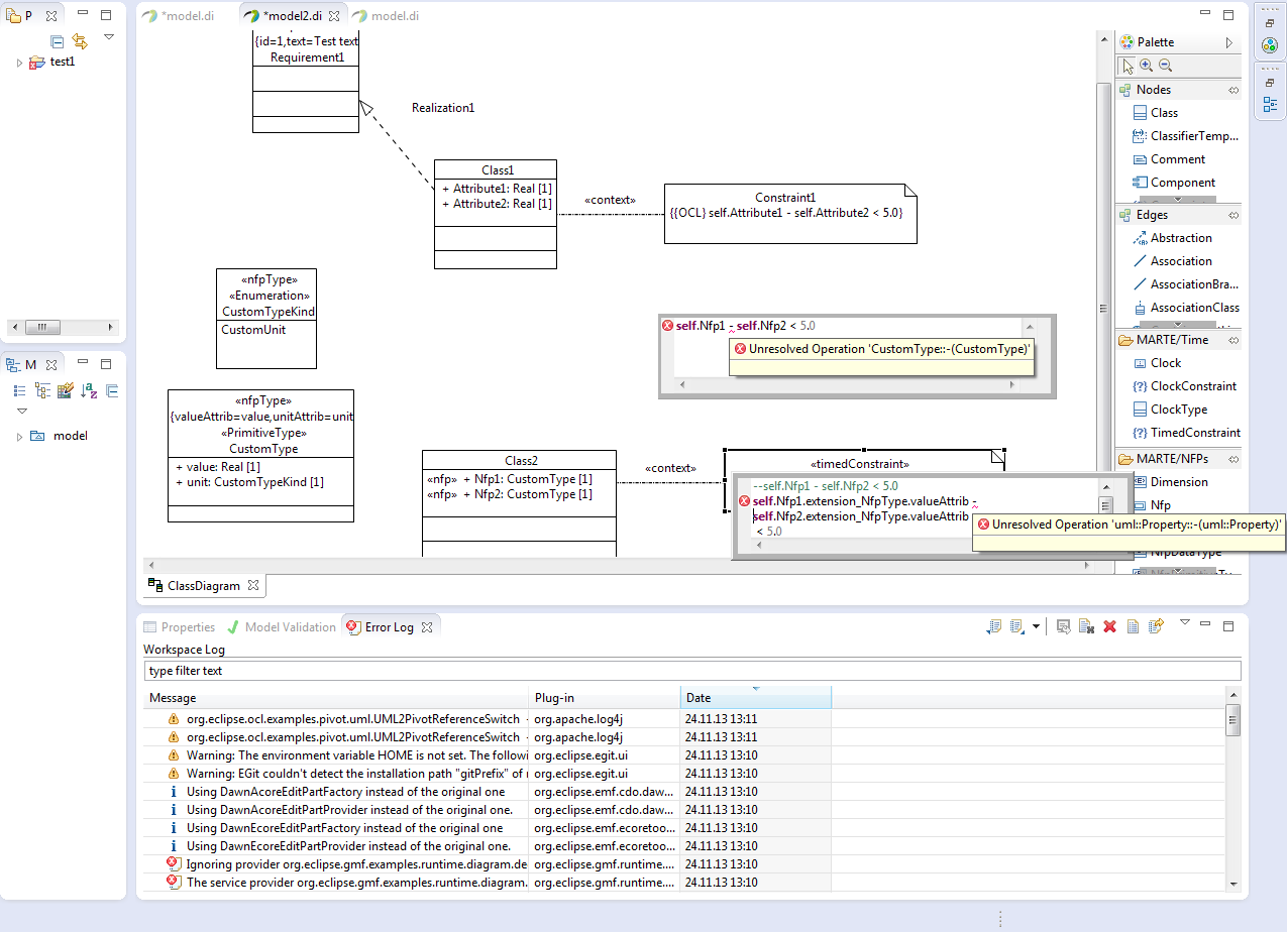

Thank you Ed,
You are incredibly helpful. I am only starting to learn OCL, so perhaps I don't know the right way to access the needed property. But, so far I couldn't find some information about using custom types in OCL.
This is what I am trying to achieve:
index.php/fa/16807/0/
I am sure I saw a constraint for the Nfp somewhere that was in the form "self.Nfp1 < (5, CustomUnit)". I have tried this as well, and maybe it is not possible in OCL. I thought if I can overload the operator in OCL to work for CustomTypes, or if I can access the 'value' of the custom type, that it would work.
Thank you,
Damjan
  • Attachment: ocl_nfp.png
    (Size: 83.68KB, Downloaded 519 times)

Re: Custom primitive types in OCL [message #1207448 is a reply to message #1207269] Sun, 24 November 2013 10:42 Go to previous messageGo to next message
oclAsType(Real) might make the compiler error go away, but I doubt that
it will execute.
You still need to associate your CustomType with a sensible behaviour.
How would you expect a tool to use your type?
For an arbitrary Java class the only guaranteed method is toString().
Eclipse OCL could use it, but it's such a stupid approach that I've only
just thought of it. You really need to use something that implements the
java.lang.Number API.
