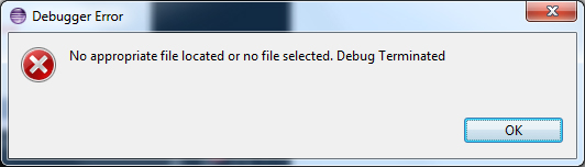

i have some issue to correctly setup the PHP debugger in Eclipse Kepler SR1 build 20130919-0819.
[ I don't know if this is the right place, so please moderators, if it's not the correct place, just move this post to the appropriate forum. thx. ]
my web server is a virtual machine with a particular fixed IP address, where xdebug is installed. Server works perfectly now since 1,5 year.
i had to reinstall Eclipse platform on my computer and unfortunately i lost the settings for remote debugging.
i watched several youtube videos how to setup everything on server (virtual machine) and on my local computer (the debugging machine), however i have some issue while debugging.
i use Chrome and firefox with xdebug plugins to catch the breakpoints.
when FF or chrome trigger the breakpoint, eclipse get the focus and display the message attached as attachment.
index.php/fa/16781/0/
i guess my issue is when i setup the Windows > Preferences > PHP > Debug > PHP Servers.
Has someone already been successful to that ?
I need your help.
thx
[Updated on: Thu, 21 November 2013 11:13] by Moderator
Re: Eclipse and PHP debugger XDebug [message #1201917 is a reply to message #1198782] Thu, 21 November 2013 19:21 Go to previous messageGo to next message
>No appropriate file located or no file selected. Debug Terminated
It simply means there is no corresponding file(local copy) in your workspace.
Xdebug is working fine and PDT is receiving debug-messages properly, but PDT could not find out the debugging target php file in your workspace.

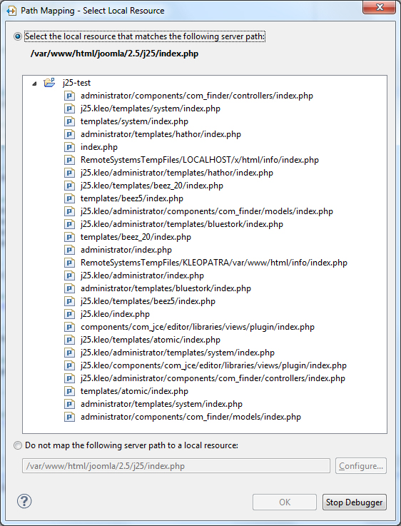

Re: Eclipse and PHP debugger XDebug [message #1211539 is a reply to message #1208924] Tue, 26 November 2013 08:42 Go to previous messageGo to next message
Hi Dave,
first of all, very thx for the link to documentation, i discovered new things and understood why some settings were useless in my case.
i review everything with documentation and checked several time the path mapping, but i still have the same issue.
When in Chrome browser i run the xdebug plusing and load the page to debug, PDT displays the mapping window asking me to map server index.php to local index.php (see screenshot)
index.php/fa/16829/0/
even if i do it with the correct index.php on local / project side, i still do not debug the function i want to Sad
so what am i doing wrong ?
[Updated on: Tue, 26 November 2013 08:43] by Moderator
Re: Eclipse and PHP debugger XDebug [message #1211563 is a reply to message #1211539] Tue, 26 November 2013 08:59 Go to previous message
ok, now i discovered that i was wrongly mapping a file... now it works well.. gooood !!!! finally my preferred IDE can debug remotely Very Happy thx Dave.
