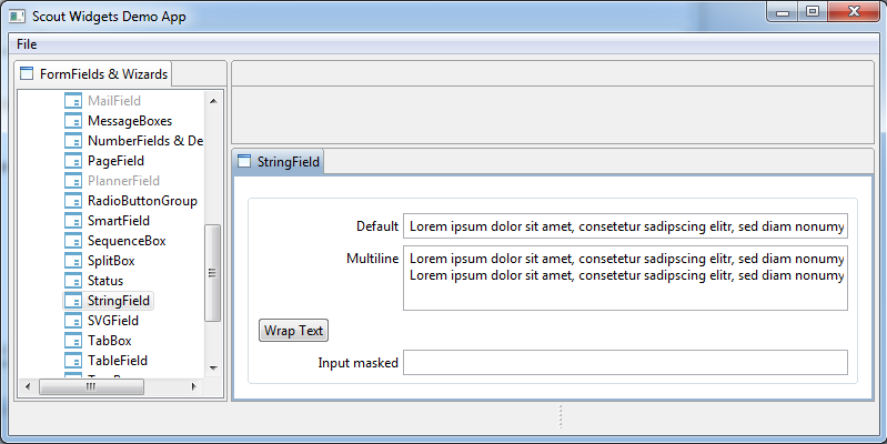

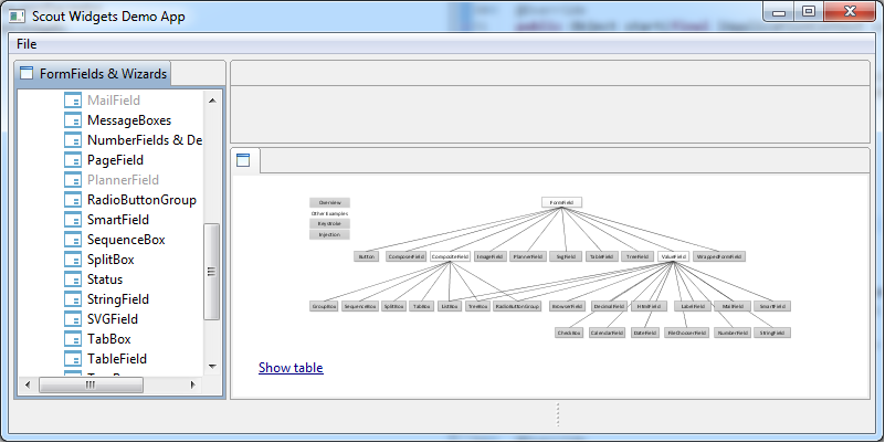

I tried our demo widget application (Wiki: http://wiki.eclipse.org/Scout/Demo, Git: https://github.com/BSI-Business-Systems-Integration-AG/org.eclipsescout.demo.git) and I got the following behaviour:
1) I expand the outline tree
2) I scroll down a little bit
3) I select a node in the outline tree
My horizontal scrollbar stays at its position as I would expect (tried several times). I also attached two images, before I clicked on the the node and after I clicked on the node (StringField).
