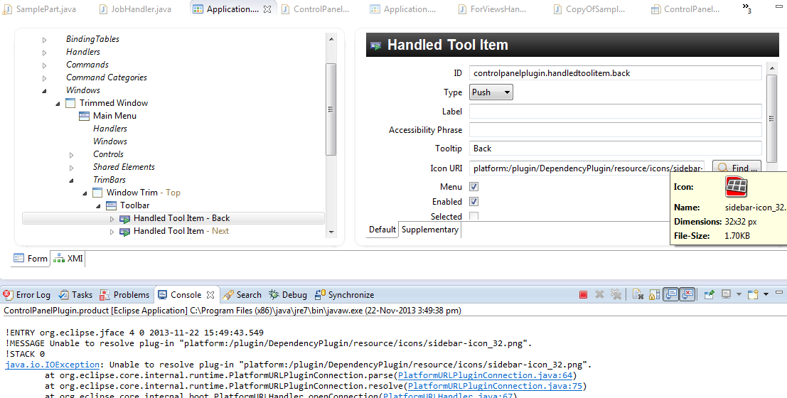

Infact when I use the DependencyPlugin for the handled toolItem it is able to show the image when hover the mouse on the URL but it is not displaying image on ToolItem.
And still I'm getting the same exception as mentioned above
java.io.IOException: Unable to resolve plug-in "platform:/plugin/DependencyPlugin/resource/icons/sidebar-icon_32.png".
I'm attaching the screenshot to explain it. Please have a look. index.php/fa/16795/0/

I got answer by myself. I was passing wrong URI.
I read EclipseRCP article by vogella very carefully and it clearly mentioned in Table 3. URI pattern that
"Identifier for a resource in a plug-in. "platform:/plugin/" is a fixed schema, followed by the Bundle-SymbolicName of the MANIFEST.MF file, followed by the path to the file and the filename. "
In the Resource URI I was not passing Bundle-SymbolicName that was the cause for the exception.
I was passing "DependencyPlugin"(Plugin Name) instead of "com.barco.cms.dependency"(Bundle-SymbolicName).

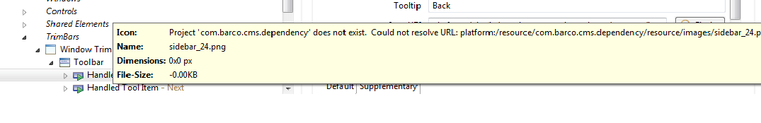

Now I can see icon from different plugin to my ControlPanel Plugin, but now on mouse hover on Icon URI I'm getting some message. How can I resolve that also.
index.php/fa/16796/0/Please see attached screenshot
