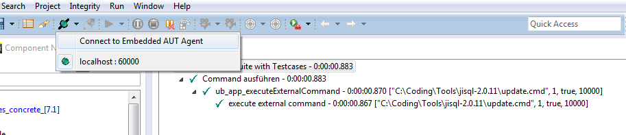

thank you very much for your reply! Since I'm using the eclipse Plugin, I'm starting the AUT agent on the same machine manually via eclipse, either via "Connect to Embedded AUT Agent" or "localhost: 6000" (Is that what you mean with separate agent?). Connecting via "localhost: 6000" does only connect if I connected via the "Embedded AUT Agent" before and disconnect. It seems the (embedded?) AUT Agent remains started.
index.php/fa/16735/0/
At the end unfortunately it doesn't make any difference how I start the AUT Agent concerning my db update problem.

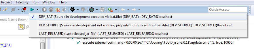

The AUT ist started manually via the eclipse plugin button applying a AUT configuration using 'Executable File Name'="C:\Coding\Workspace\MyApp\MyApp.bat" before executing the script.
index.php/fa/16736/0/
The .bat-File looks like this:
java -classpath C:/Coding/Workspace/MyApp/bin;C:/Coding/Workspace/MyApp_Libs/*; com.festo.deva.Main
