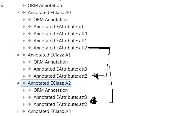

I created an model: the entity "A0" has an attribute "att2" (@ElementCollection)
"A0" is an interface. "A1" and "A2" extend "A0".
In these two classes I want to rename the relation "att2" to have two tables in the database.
I tried to create the file orm but without success: the generator always puts me in the same name: "test1_A0_att2," even if the redefined attribute att2 at the level of classes A1 and A2.
index.php/fa/16662/0/
How do I change this value?
I attach the model and its orm file

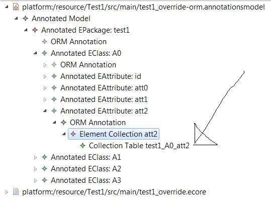

Re: [Texo] overwrite @CollectionTable with the ORM file [message #1173547 is a reply to message #1173442] Wed, 06 November 2013 10:48 Go to previous messageGo to next message
I've already tried. The flag is set to false.
The annotation "@CollectionTable" is always generated.
If I create the file orm, texo always puts the annotation.
index.php/fa/16670/0/
  • Attachment: img2.jpg
    (Size: 65.02KB, Downloaded 584 times)

Re: [Texo] overwrite @CollectionTable with the ORM file [message #1174695 is a reply to message #1174003] Thu, 07 November 2013 04:02 Go to previous messageGo to next message
I have set option to false.
I have generated the code without having the orm file and I get this:
A1 { ...
@ ElementCollection ( )
@ CollectionTable ( name = " test1_A0_att2 " )
private List <long> att2 <long> = new ArrayList ();
A2 { ...
I have generated the ORM file and I see that I put the annotation "@CollectionTable" by default.
I remove the annotation "@CollectionTable" from the file, but texo continues to put the annotation of the generated code.
I do not have the possibility to remove the annotation or overwrite the annotation.
In my first post there is a model for testing.
