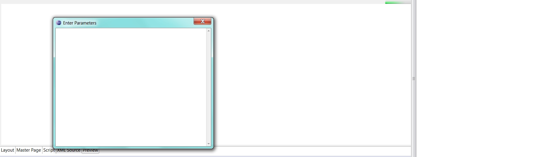

I created some reports for my manager and they works fine in my Eclipse.
It is Eclipse Reporting Kepler.
All resource files and libraries are in same folder C:\eclipse\...
I copied it also to my colleague computer and when he puts it on C also it works fine.
But when I copy it to my manager's computer it can connect to database (I can see results in Data Set) so it has connection to database, but when I try Preview or to run it Web Viewer Nothing happens, just like it is loading all the time.
Enter Parameters Window does not displays anything.
I do not know what can be the problem.
I have WIN 7, my colleague also has Win 7 (on his computer works), my manager has Win 8.
I have JAVA 1.6, My colleague has 1.7 and my manger has 1.7.
I am sending in attachment what happens when I try Preview:
I can not enter any parameters.
I will really appreciate any help this is so strange behavior to me.
What can be the problem (Windows, Java..)?
THANK YOU!!!

I've heard that several folks are having issues when using Windows 8. Can you please log a bug for this and post the bug info in here? Thanks!
