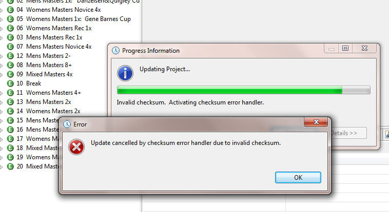

I'm making good progress getting EMFStore to work with my application. I
found a workaround for the exception thrown when a model element
contained in a Resource is added to EMFStore.
Since the robustness of the store is critical for my application, this
checksum problem I've run into worries me.
How do I recover from a checksum error like the one in the screenshot?
EMFStore is attempting to do an update from the server and fails. Does
recovery from this kind of error result in data loss?
Scott
Re: [EMFStore] Recovery from checksum error [message #1164321 is a reply to message #1161873] Thu, 31 October 2013 11:45 Go to previous messageGo to next message
Hi Scott,
sorry for the late reply, we have been at EclipseCon during the last
couple of days and were pretty busy with our talks.
By default EMFStore will check the consistency of the model on the
client with the model on the server on update and commit. The server
sends a checksum of the model in a particular version to the client and
the client compares it with its checksum. In case they are not equal the
client will call a ChecksumErrorHandler. The default error handler just
cancels the commit or update, since a checksum error is usually a sign
that something is wrong with your model. I will go into details about
what this could be in the following. You can register an Checksum
at the extension point
org.eclipse.emf.emfstore.client.checksumErrorHandler. If you want the
mismatch between client and server automatically resolved (without data
loss) you could register ChecksumErrorHandler.AUTOCORRECT in package
org.eclipse.emf.emfstore.internal.client.model.util in
org.eclipse.emf.emfstore.client.model. (The class is internal at the
moment.) The handler will re-checkout the project and reapply local
changes as necessary.
However I think it is usually important to find out why the mismatch of
checksums occurred. From my experience it could be custom code in your
model or some special configuration in your Ecore. Do you have custom
code in your model? Can you share your Ecore here or privately?
Maybe your workaround is related to the new problem? How did you work
around your other problem?

Re: [EMFStore] Recovery from checksum error [message #1164448 is a reply to message #1164321] Thu, 31 October 2013 13:43 Go to previous messageGo to next message
Thanks for that explanation, Maximilian. Good to know that there is a
simple way to resolve checksum problems for production situations.
As a developer like you that has to support users, I very much
understand the need for good forensic data to diagnose problems.
Unfortunately, I've only been able to make this problem occur once in my
application and have not been able to create a test case that
demonstrates the problem. I'll avoid using the AUTOCORRECT feature in my
development environment so I'll know if it occurs again. Does the
EMFStore client or server log any data that would be useful in getting
to root cause? I suspect that root cause of the corruption occurs long
before the checksum finds the problem, so I understand your interest in
the model.
Yes, I can share my ecore model --- both the .ecore and .genmodel are
attached. And, yes, I have a small amount of custom code in the
generated EObjects. The vast majority of the custom code is outside the
generated classes themselves, though. I stay with EMF's standard
generated code for most everything. What sort of custom code could cause
checksum errors?
It's possible that this checksum is somehow related to the exception
thrown, because the problem has not recurred since I started removing
all model elements from their Resources before adding them to EMFStore.
You know your code, so you could speak to the actual likelihood of that.
Scott

Re: [EMFStore] Recovery from checksum error [message #1165535 is a reply to message #1164448] Fri, 01 November 2013 06:59 Go to previous messageGo to next message
I spoke too soon. The checksum occurred again.
Is there some diff-type utility and/or procedure to determine the
difference between the models with different checksums on the client and
server? Could EMFStore be instrumented to log some forensic data when
the checksum occurs to determine the immediate cause of the checksum?
Maybe this would lead us one step closer to root cause.
Scott
>>> Scott

Re: [EMFStore] Recovery from checksum error [message #1170606 is a reply to message #1170485] Mon, 04 November 2013 14:18 Go to previous messageGo to next message
Thanks, Edgar.
It'll be great to have a checksum handler that can log data to help with
getting to the bottom of checksum problems. Glad to hear it's already on
the TODO list.
EMFCompare's diff utility would seem to be the right tool for finding
the differences, since it can report more EMF model-level difference
information ---- graphically in Eclipse.
Would you expect diff'ing the client and server XMI artifacts to yield
clues to the cause of the checksum? I don't understand the process that
EMF goes through during an update when I see this problem, so I have a
question:
What versions are being compared using their checksums during an update?
The checksum surfaces during an update. For example, in the situation
where the server has V2 of the project and the client has V1, does the
update action cause the change set to be downloaded, applied to V1
making it V2 and checksum computed on the client's new V2 and compared
with the server's V2 checksum? Or are the V1 checksums on both sides
compared before the operations are downloaded and applied? I ask because
this would impact what diff's would be meaningful to compare.
Scott

Re: [EMFStore] Recovery from checksum error [message #1171508 is a reply to message #1170606] Tue, 05 November 2013 04:27 Go to previous messageGo to next message
Hi Scott,
your initial assumption about the checksum computation is almost
correct. There's only one additional subtlety, that is, that you have to
deal with local pending changes, too. Therefore here's the detailed
process for computing the checksums for both commit and update.
In case of an update, the project being updated will first resolve the
version to update to on the server (in most cases this will be HEAD).
The resolved version will contain a project state checksum field which
has been generated while the most recent commit on the server did happen
for the project. The resovled version is also used to fetch the
changepackage that contains all operations that need to be applied on
the project.
Now, while updating, all pending local changes on the project are first
being reverted. This leaves you with a 'clean' project, without any
local operations. Than the incoming changepackage from the server will
be applied upon the project and the checksum is computed. This checksum
will be compared against the checksum that is contained in the version.
The update process then continues by re-applying the local changes.
In case of a commit, the client will receive the most recent version as
a return value. This version contains the checksum as computed by the
server. We don't have to care about any local pending changes, since a
project can't contain such after a commit. So, the client may compute
its own checksum for the project and compare it against the checksum of
the version.
We also know about EMFCompare, but for error diagnosis it often is
enough to just load both project states files in a diff editor and
hightlight the lines that differ. In most cases this already gave us a
clue about what why the checksum computations did fail.
I hope this helps.
