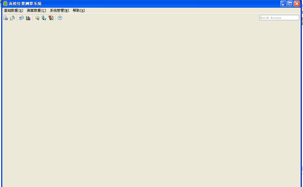

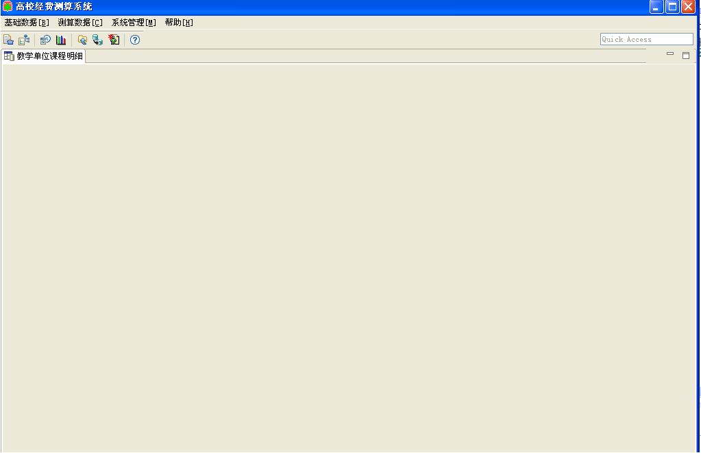

This is a example come from a book. createInitialLayout()in Perspective.java:
//layout.addStandaloneView(IAppConstants.TEACH_UNIT_CLASS_VIEW_ID, true, IPageLayout.RIGHT, 0.26f, editorArea);
layout.addView(IAppConstants.TEACH_UNIT_CLASS_VIEW_ID, IPageLayout.RIGHT, 0.26f, editorArea);
layout.getViewLayout(IAppConstants.TEACH_UNIT_CLASS_VIEW_ID).setCloseable(false);
layout.getViewLayout(IAppConstants.TEACH_UNIT_CLASS_VIEW_ID).setMoveable(false);
If I use addView(), A view will be shown in UI. If use addStandaloneView(), I get nothing in UI.

I have found the reason. It can work at eclipse 3.7.2, don't work at eclipse 4.3 or 3.2 . It is a compatible problem.
