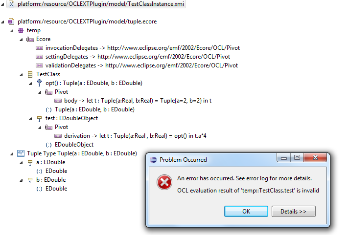

I have attached a plugin(developed in Kepler). It is very simple plugin with one package "tupletest1".
It contains file TestTuple.java. In this file an Ecore model is created programmatically consisting of one class. Class has one attribute(name = test, type = Real) and one operation(name=opt, type = Tuple(Real, Real), arguments=none).
The OCL statement for attribute is "let t : Tuple(a:Real , b:Real) = opt() in t.a*4" and the OCL statement for operation is "let t : Tuple(a:Real, b:Real) = Tuple{a=2, b=2} in t"
The class TestTuple is instantiated in class View.java(simple view onCreate instantiation for TestTuple is performed).
When i try to evaluate attribute using setting delegates then i get the following exception
org.eclipse.ocl.common.internal.delegate.OCLDelegateException: OCL evaluation result of 'temp::TestClass.test' is invalid
Do you have any clue wht tuple is problematic in the given code.
Cheers

Re: OCL Tuples in pivot [message #1162198 is a reply to message #1160867] Wed, 30 October 2013 04:08 Go to previous messageGo to next message
You didn't specify how to run your code; Opening a Perspective named
Perspective is a very odd approach.
I have no idea why you are doing such low level model creation. It is
incredibly hard, but if you're going to ignore the higher level aids you
should expect to debug your own problems.
If you added a
Diagnostician.INSTANCE.validate(modelPackage);
you would have noticed a couple of
The feature 'eType' of
'org.eclipse.emf.ecore.impl.EOperationImpl@11db0bc{test.ecore#//TestClass/opt}'
contains a dangling reference
'org.eclipse.ocl.ecore.impl.TupleTypeImpl@129751d{#//}'
The feature 'eClassifier' of
'org.eclipse.emf.ecore.impl.EGenericTypeImpl@c7c79e{test.ecore#//TestClass/opt/@eGenericType}'
Once you fix those, you will notice that your tuple parts are unnamed,
causing the operation lookup failure and so the eventual failure.
When writing very complicated stupid code expect the problem to be in
your code so debug it properly.
Now go back to your original messages and ask yourself how anyone could
have answered your question sensibly.
Ed Willink

Re: OCL Tuples in pivot [message #1162253 is a reply to message #1162198] Wed, 30 October 2013 04:51 Go to previous messageGo to next message
Sorry for giving incomplete information.
You can run the plug-in as Eclipse Application (menu Run->Run As->Eclipse Application).
The perspective/GUI is just for the testing... just ignore that.
Dangling reference problem is solved (i added tupletype in package).
I have also given names to tuple parts but still i am getting the same exception when i try to evaluate using dalegates.
Please check the attached project. Thanks!

Re: OCL Tuples in pivot [message #1162418 is a reply to message #1162253] Wed, 30 October 2013 07:05 Go to previous messageGo to next message
I'm sorry. I have no more time to spend on your crazy code.
Ed Willink

Re: OCL Tuples in pivot [message #1162527 is a reply to message #1162418] Wed, 30 October 2013 08:44 Go to previous messageGo to next message
I understand that you are busy. I have created a simple ecore file. Please open the file in Kepler build. It contains one Class(TestClass) having one attribute(test) and one operation(opt). There is no validation error. Validation is successful, but when i try to instantiate the class (name = TestClass) then it give me the same error.
open the ecore in simple ecore model editor and right click the class(TestClass) and select "create dynamic instance", save the xmi file and open it in sample ecore reflective editor.
open first tree node for instance.
index.php/fa/16610/0/
thanks for your time
  • Attachment: tuple.ecore
    (Size: 2.12KB, Downloaded 257 times)
  • Attachment: tuple.png
    (Size: 47.62KB, Downloaded 927 times)
Re: OCL Tuples in pivot [message #1162668 is a reply to message #1162527] Wed, 30 October 2013 10:36 Go to previous messageGo to next message
Your model has a variety of problems, most notably the use of "(" in
names rather than EGenericType.
Basically you seem to be trying to workaround
https://bugs.eclipse.org/bugs/show_bug.cgi?id=392059,
https://bugs.eclipse.org/bugs/show_bug.cgi?id=401938.
This bug is getting really irritating; must be time to fix it.
Ed Willink
