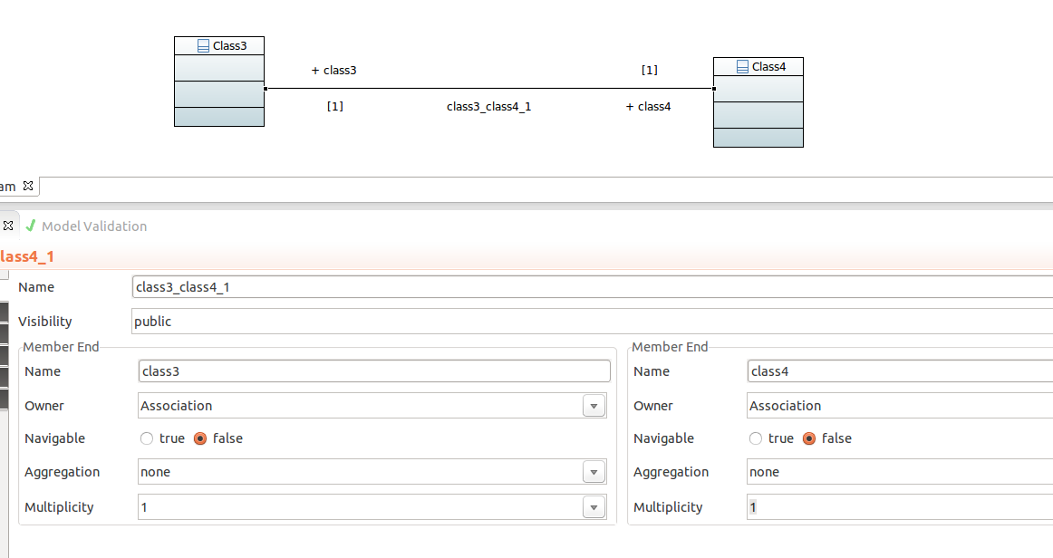

Hi Christian,
Thanks for your answer.
I've done what you suggested, and as you can see in the picture, there is still a role for both classes (+ class3 and + class4), although both ends are non- navigable.
But actually I want to achieve an association without roles at the end(s). And this does not work with the navigable preference, does it?
Or do I missunderstand something?
Best Regards,
Martin
Re: unidirection Association in class Diagramm [message #1157817 is a reply to message #1156806] Sun, 27 October 2013 09:38 Go to previous messageGo to next message
Hi Martin,
A UML Association needs at least two ends (each end is a Property). If you don't want these properties to belong to the class, you can make them "Owned by Association". If you want a unidirectional association, then maybe the first end should be owned by the Classifier, and the other one by the Association.
And if you really want a single Property, then you can just create a Property in the Classifier A, and type it with Classifier B (But then, this is not an Association anymore).
Camille

Re: unidirection Association in class Diagramm [message #1160588 is a reply to message #1160569] Tue, 29 October 2013 04:13 Go to previous message
Both are roles. But depending on your code generation and target platform, they may or may not appear in the final product.
In a Database, for examples, some Associations are represented as Tables. The table typically needs the two ends. In a Java Class, associations are represented as Attributes (And sometimes, specific collections to ensure consistency with the opposite end).
My point is that the UML Model is (should be) an abstraction. It will always contain extra information (Useful in some specific cases, useless in other). So, there's no universal answer.
But for the simplest code generator, "owned by association" often means "ignored"; which is, if I understand correctly, what you want.
Camille
