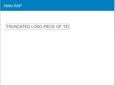

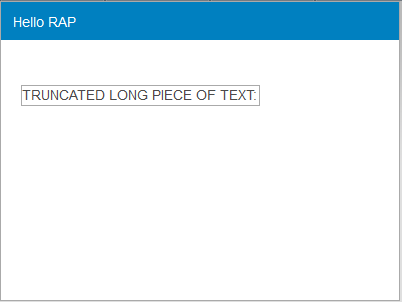

Hi Everyone,
I've currently doing some work on a RAP application and have encountered a strange issue with Label sizes. What I'm trying to do is determine the largest width Label on a form and set all the labels to the same widthHint in a GridLayout. The means that in a two column layout of "buddied" controls (e.g. a Label and a Text control in each column) the layout is symmetrical.
This works great in a matching RCP application but what's happening in RAP is that that the first time the app is loaded in a browser the longer labels are being truncated because the width calculation is not returning the correct value.
If I refresh the page in the browser the text size calculations are corrected and the labels display untruncated.
The issue seems to happen in the text size estimation code but I'm not sure why refreshing the page in the browser is resetting the calculation.
I've attached screenshots from a simple hello app to demonstrate the before and after refresh display. The code used to create the control is as follows:
Composite container = new Composite(parent, SWT.NONE);
GridLayoutFactory.fillDefaults().applyTo(container);
Label label = new Label(container, SWT.BORDER);
label.setText("TRUNCATED LONG PIECE OF TEXT:");
label.pack();
GridDataFactory.swtDefaults().hint(label.getSize().x, SWT.DEFAULT).applyTo(label);
Any ideas on how to work around this?

Re: Label text is initially truncated [message #1143949 is a reply to message #1143270] Fri, 18 October 2013 10:38 Go to previous messageGo to next message
this is an expected behavior and it's how Text Size Determination (TSD)
works in RAP.
- When the application is started for the first time (after server
start) the size of the text "TRUNCATED LONG PIECE OF TEXT:" is estimated
(real text size in browser is not known yet)
- Text is sent to the client for measurement.
- With the next request real text size is send to the server and
re-layout is performed to adjust the widget bounds.
- The real text size is kept into a "text size database"
- With the next application start (reload), the text size is already
know (available in the "text size database") and it's used directly.
I hope that this explains it.
Best,
Ivan
