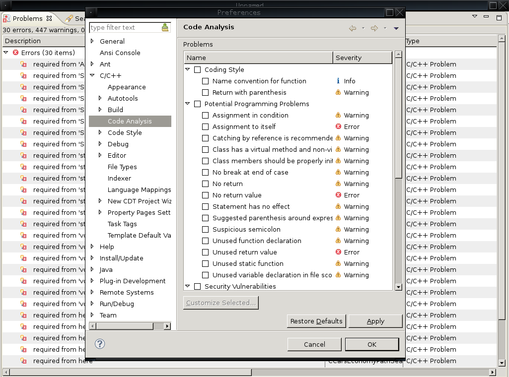

I have in my C++ project bunch of errors reported in Eclipse starting with a line "required from...", project compiles fine, works perfectly, daily tested on valgrind, Xcode instruments etc. So no error for sure.
I thought it's due to broken code analysis thus it's switched off for some time. Unfortunately no luck - with code analysis switched off these errors are still being displayed (see screenshot attached). I'm on Eclipse 4.2.2
Actually it's a question of how to fix these errors in my project rather if that's a broken analysis tool. I do believe code analysis tool is trying to tell me something, but it's totally meaningless "required from"? what does this mysterious message mean? Can somebody who implemented that feature explain what's the point in garbling my project errors log with meaningless messages? What exactly this message means?

That is an error message from the compiler and *not* from CODAN. In the Problems view you can see that the error is categorized as type "C/C++ Problem".
