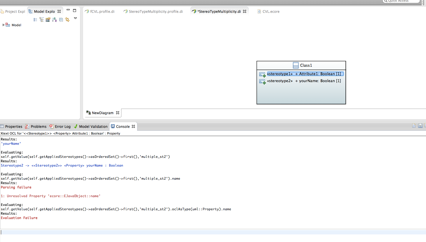

At least this is what I (think I) tried. However, I don't succeed in debugging the erroneous OCL constraint in my example profile in this way (see attached project in original message). So, as I tried to explain in my original post, I select Attribute1 in the StereoTypeMultiplicity.uml model and then try to use the OCL console to figure out what's wrong (see also attached screenshot!)
self.getValue(self.getAppliedStereotypes()->asOrderedSet()->first(),'multiple_st2')
correctly resolves to {{Stereotype2 -> <<Stereotype2>> <Property> yourName : Boolean}}
However, the call to
self.getValue(self.getAppliedStereotypes()->asOrderedSet()->first(),'multiple_st2').name
results in a parsing failure, which I tried to circumvent using
self.getValue(self.getAppliedStereotypes()->asOrderedSet()>first(),'multiple_st2').oclAsType(uml::Property).name
But then I end up with an "evaluation failure" as you can see in the screenshot. Could you explain me concretely for this example what I could additionally or alternatively do to debug the "invalid" result" exception that occurs when evaluating the "Mass Version of dont call me your name!" constraint?
Thx,
Klaas
Re: Debugging OCL constraints in UML profiles [message #1137608 is a reply to message #1137538] Mon, 14 October 2013 12:08 Go to previous messageGo to next message
I am not convinced that getAppliedStereotypes() is necessary. It seems
to be a bad API that tries to workaround deficient OCL functionality.
Bad, because it loses type information and in the case of collections
requires troublesome Object/Collection casts.
The pivot-based approach endeavours to make base_XXXX and extension_XXXX
work as indicated by the UML specification. When the UML
metamodel/profile is loaded and realized as a pivot model, the synthetic
base_XXXX / extension_XXXX at M2 are reified as static properties at M1,
so that they can be navigated in a relatively conventional fashion.
So rather than
"self.getValue(self.getAppliedStereotypes()->asOrderedSet()->first(),'multiple_st2')",
I think it should be possible to write something like
"self.extension_multiple_st2->first()" if you expect success, or guard
with oclIsInvalid() if you're unsure that the extension exists.
Ed Willink
> Thx,
> Klaas

OK (I guess you mean "self.extension_Stereotype1.multiple_st2->first()", right?
However, the "extension_" stuff doesn't seem to work Sad
This happens with xtext console and having selected Attribute1 as context element
Evaluating:
self
Results:
<<Stereotype1>> <Property> Attribute1 : Boolean
Evaluating:
Results:
Parsing failure
1: Unresolved Property 'uml::Property::extension_Stereotype1'
Klaas
