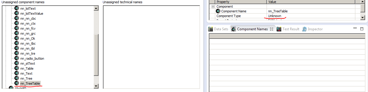

Could you please take a look ay the following problem - sometimes common component name (like nn_nn_text) obtains type 'Unknown' that leads to impossibility of using keywords with propagated component names, therefore it is required to drop current test db revision and return to previous version (at least a whole working day is lost).
1. Here is a screen where 'nn_TreeTable' became 'Unknown'

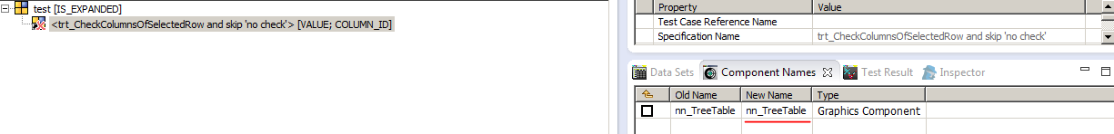

2. Here is a screen where this component name is used.

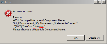

3. And here is an error when I insert real component name of 'TreeTable' type.
