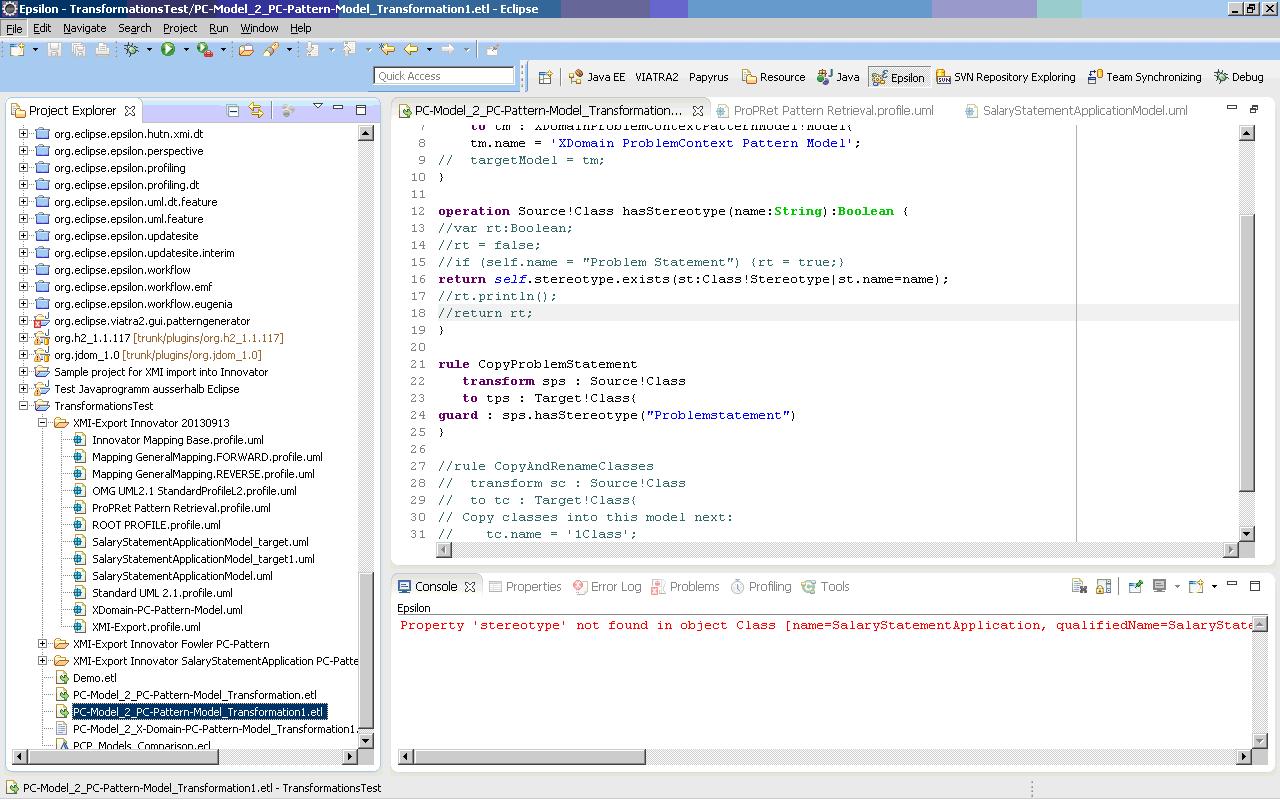

in my ETL module, I want to restrict transformations to elements with a certain stereotype. Hence, I need to determine the stereotype of the elements. I do this using an own operation called "hasStereotype", see the following code.
operation Source!Class hasStereotype(name:String):Boolean {
return self.stereotype.exists(st:Class!Stereotype|st.name=name);
rule CopyProblemStatement
   transform sps : Source!Class
   to tps : Target!Class{
guard : sps.hasStereotype("Problemstatement")
Unfortunately, when I try to run this transformation, I receive an error, see the attached screenshot of the code and the error message.
I provide a detail description and minimum example concerning my project in a note and a zip file besides the screenshot of the code and the error message in the attachment to this message.
Any helpful hint is very much appreciated.
Kind regards, Alexander

According the the EPackage Registry view, Class in UML doesn't have a "stereotype" property (at least in the version of UML that ships with Kepler). You probably need to use getAppliedStereotypes() instead.
