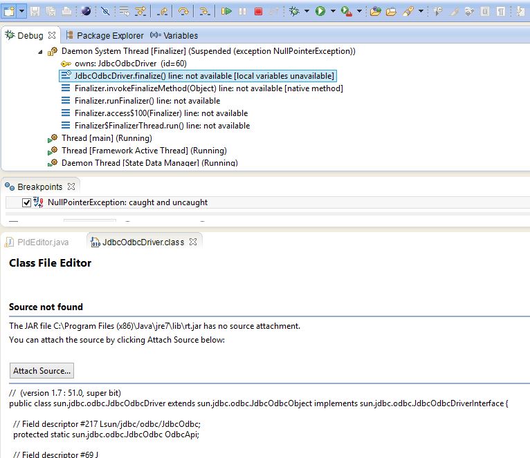

Re: error while deleting [message #1130307 is a reply to message #1128963] Wed, 09 October 2013 08:21 Go to previous messageGo to next message
Thx Ed for your hints. It's an NPE and setting the exception breakpoint gave me this:
index.php/fa/16431/0/
Regarding tracking the further processing of the error; it goes next to PartRenderingEgine.java to the method Object run(final MApplicationElement uiRoot, final IEclipseContext runContext), where it enter the catch(Exception ex) statement and afterwards stay at the while loop.

Re: error while deleting [message #1130333 is a reply to message #1130307] Wed, 09 October 2013 08:51 Go to previous message
Phil,
It doesn't look like the exception you show in the image is really the
one from TabbedPropertySheetPage from previous stack traces you show. I
assume you have looked at the error log because I imagine the exception
you were trying to track down originally is being looked with a full
stack trace. Have you looked closely at the source code for
TabbedPropertySheetPage to see where the error there is?
