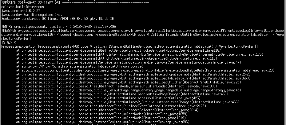

When I start my application in eclipse everything is fine. Once it also worked in Tomcat7, but for some reason it does not work any more. I always get an error. I made sure that tomcat is still fine, as i tried a tomcat6 on a different machine.
I'm not quite sure were to start debugging or having a look, as in eclipse is everything fine.
Kind regards Silvan.

A server error might have occured, does the attachment describe the client log output? Do you also have any server output (might be somewhere in the Tomcat log files)?
Re: Problem after deploying to tomcat [message #1122164 is a reply to message #1121663] Tue, 01 October 2013 05:33 Go to previous messageGo to next message
yes in the picture was what i could see as result of catalina log.
I had a look again into the log dir of the tomcat7. (It's a stock debian wheezy, so in /var/log/tomcat...) With a current date i basically have: catalina.out, catalina.2013-09-30.log, localhost.2013-09-30.log and localhost_access_log.2013-09-30.txt. In my understanding the server log should also go to catalina.out.
