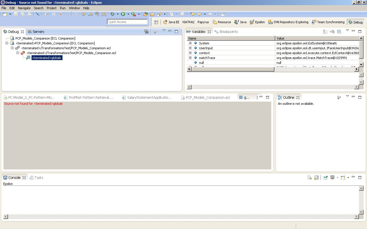

thanks a lot for your answer. I followed your suggestions. First, I tried to get information via the print statements. However, there was no output from them. Hence, I then performed the module in debug mode. However, to be honest, I cannot interpret the error I found, see screenshot of the error from the debugger. What does this mean?
Thanks and kind regards, Alexander

Your ECL comparison ran to termination so there was no code to navigate to when you double-clicked "globals". Another way to debug is to add a pre {} block to your ECL module with a println() statement and see if anything is printed in the console.
