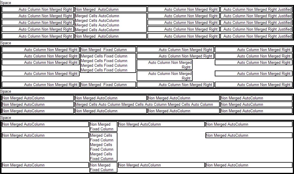

I just switched from 4.2.2 to 4.3.1 for testing and development and just came across this same issue.
I have narrowed it down to affecting both Grids and Tables. But for me so far it seems to only happen when the columns have been been given a specific width instead of them staying auto.
I have found a work around that seems to work, I have to select cells that have been merged then under Property: Text \ Whitespace: set it to Preformatted instead of Auto.
Just a pain now to open all of the reports and make this changes. Fortunately production is still running 4.2.2

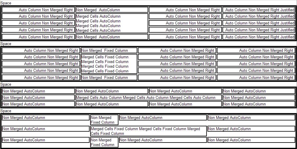

After further testing you are correct, there still seems to be a problem here. My previous observations was incorrect since the test data I was using wasn't long enough to show the clipping.
If the first column width is set to auto in the merged space, it fills the merged space and wraps correctly when setting Property: Text \ Whitespace: Normal, and clips when Property: Text \ Whitespace: Preformatted / No Wrapping.
However when setting the first column in the merged space to a fixed width, things start to have undesired results.
Re: text wrapping problem in merged cells [message #1211933 is a reply to message #1211724] Tue, 26 November 2013 12:44 Go to previous messageGo to next message
Looks like there is also some other issues with Merged Cells. When merging vertically instead of horizontally we also get some unexpected results in version 4.3.1 works fine in 4.2.2
When the Column is auto width there doesn't seem to be an issue, however when the column is fixed width there is an interesting issue. The cells in then next column to the right have an unexpected right padding added to them, however it doesn't affect the first row of the merged space only the subsequent rows.
