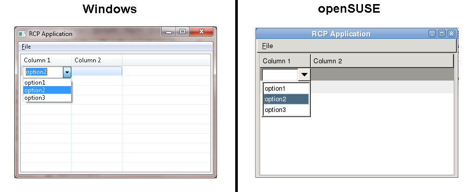

The issue is very specific to DROPDOWN in the table column. We have business case where UI is design in such a way that first 2 columns in the table are dropdowns. Based on selection in first column, 2nd column dropdown value is populated.
This aspect is working very well in WINDOWS platform where as failing in OpenSuse 11.3 linux.
Problems faced is that when there is focus on one of the dropdown values in first column and then user navigates to 2nd column using mouse click and not TAB action of keyboard, the focuses dropdown value in first column does not get auto selected and populated in the cell leading to 2nd column having incorrect data.
I have attached the snapshot of the UI in the document.
Have anyone faced such issue. Need pointers on area to look for answers.

This issue happens with SWT Table/TableEditor in openSUSE. This issue does not occur with RedHat or Windows.
When we select the drop down value using mouse, selection happens properly. But drop down selection does not happen while using up & down arrow keys.

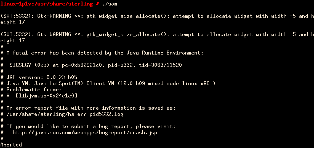

index.php/fa/17128/0/
I leveraged -Djava.library.path=/etc/gtk-2.0 parameter in .ini file of eclipse application such that it can set appropriate GTK version that is desired for application to work correctly. I did not see any change in the application for the issue reported but noticed messages as shown in attachment.
Similar message comes when I execute the application without these parameter but SWT code is 5393 instead of 5332.
Any advice here would help on next steps.
  • Attachment: error.png
    (Size: 22.58KB, Downloaded 1065 times)
[Updated on: Thu, 26 December 2013 14:05] by Moderator
Re: Dropdown issue in table column [message #1226743 is a reply to message #1224439] Thu, 02 January 2014 10:07 Go to previous message
You need to export the LD_LIBRARY_PATH environment variable before launching eclipse (or your application built on eclipse) and set its value to the path of the lib folder which contains the GTK 2.x libraries (.so files). Make sure GTK 1.x and 2.x libraries are installed in different locations.
