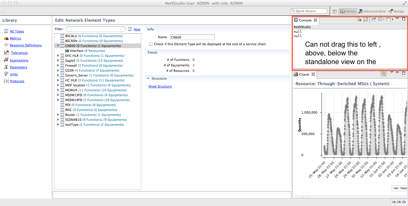

See the screenshot attached.
In 3.x I could drag "views" around a standalone view and place them,
left, above, below.
With the same code deployed with the e4 compat. layer workbench, I am
not allowed to drag a view to the left, above and below. I can only drag
it to the same placeholder holding the view.
Functionally this is different, is this intended? Should I move away
from standalone views with the e4 workbench compat. layer?
Here is the code for setting the 3.x standalone view.
layout.setEditorAreaVisible(false);
layout.addStandaloneView("com.netxforge.netxstudio.screens.selector.design",
false, IPageLayout.LEFT, 0.5f, IPageLayout.ID_EDITOR_AREA);

You should open a defect for this (it's not an enhancement because it used to work). The problem is just that the DND code currently doesn't recognize stand alone MParts as potential targets for a 'split' operation (the one that created a new sash, splitting the existing element with the one being dragged).
Re: e4 compat layer and standalone views. [message #1139405 is a reply to message #1131675] Tue, 15 October 2013 15:00 Go to previous message
I've opened the following defect to track problems with stand-alone views, I'll add this use case to the list...
https://bugs.eclipse.org/bugs/show_bug.cgi?id=384344
