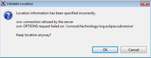

i'm trying to get access to subversive source code repository (http://dev.eclipse.org/svnroot/technology/org.eclipse.subversive/) via subversive plugin on eclipse, but the connection is refused.
index.php/fa/16289/0/
my connector is: SVNKit 1.3.8 and i tried the SVNKit 1.7.10 also.
how can i solve this?
___
EDIT: forget this reply. it's not related with the original post, and i already solved the problem.
