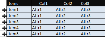

1) Table with icons (plus)
index.php/fa/16215/0/

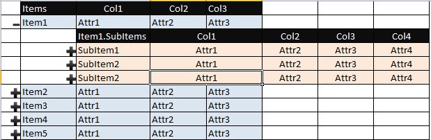

2) An item can be extended so that a different table is shown within the parent table (independent from the parents' table layout, e. g. column names or width)
index.php/fa/16216/0/

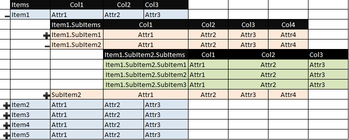

3) A subitem can be extended, too.
index.php/fa/16214/0/
Any ideas how something like this could be implemented for RAP?

Re: Nested Tables in RAP applications [message #1111441 is a reply to message #1110126] Wed, 18 September 2013 04:11 Go to previous messageGo to next message
Hi.
There is no out-of-the-box solution for such a table, so no.
Looking at the screenshots, graphically this might be possible to
represent using Nebula Grid, except for the joined cells (feasible but
not supported - independent cell-widths would be out of the question);
Or using multiple Tables in a row-layout (which would be very
heavyweight solution).
In any case, there is no viewer that could generate such a Tree/Table,
so that would have to be built it from scratch, which is a lot of work.
I would suggest to just open a new Table for a clicked item and hide the
previous one, then have a "back" button to destroy the newer one and
show the previous again. Everything else will be very complicated to built.
Greetings,
Tim
