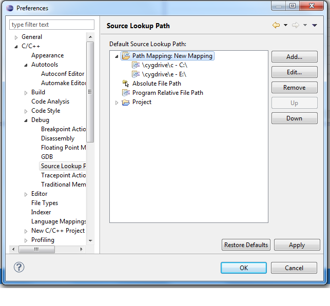

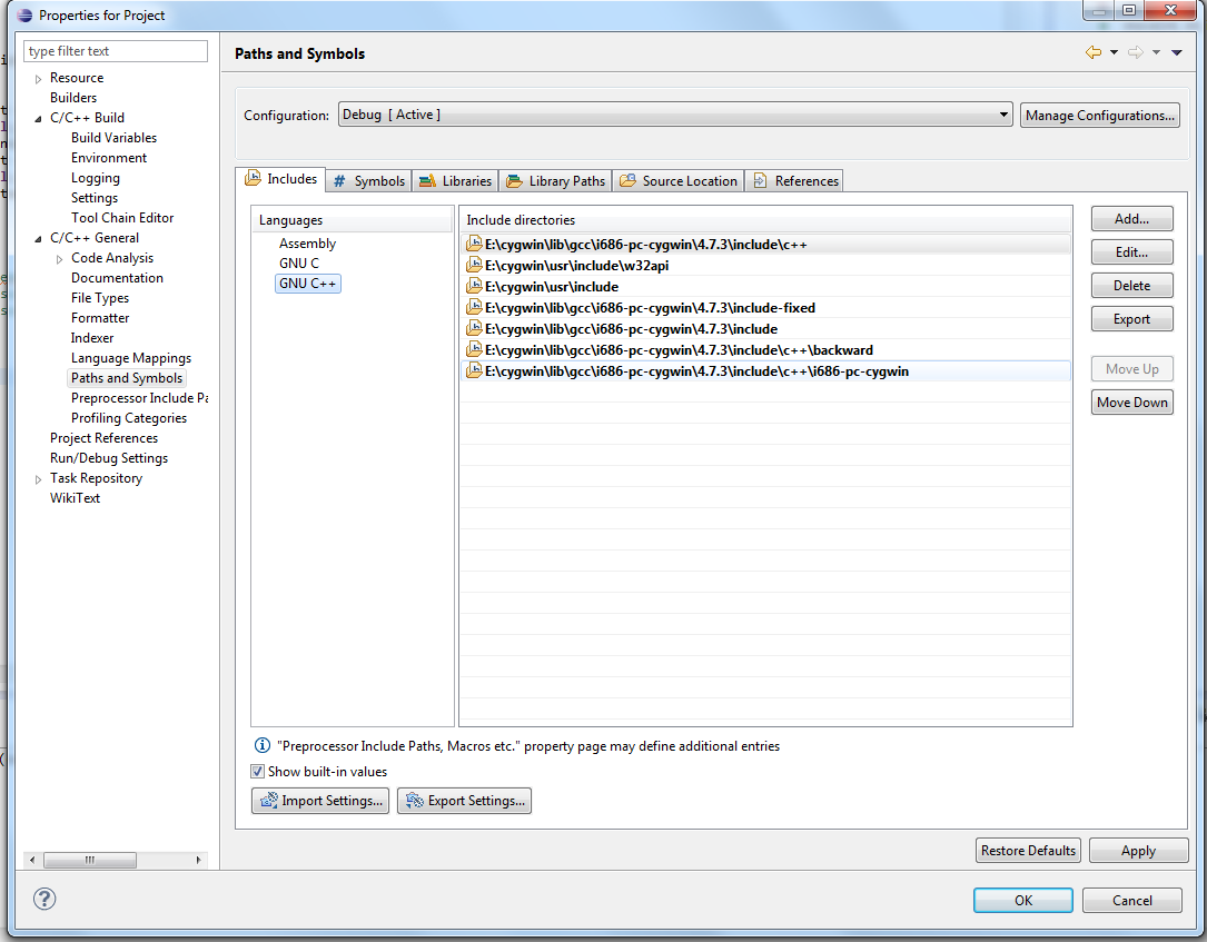

I have explicitly set path and symbols (PathAndSymbols.png) as well as Path Mapping (PathMapping.png) for Cywin in Eclipse. Files for same are attached with this post.

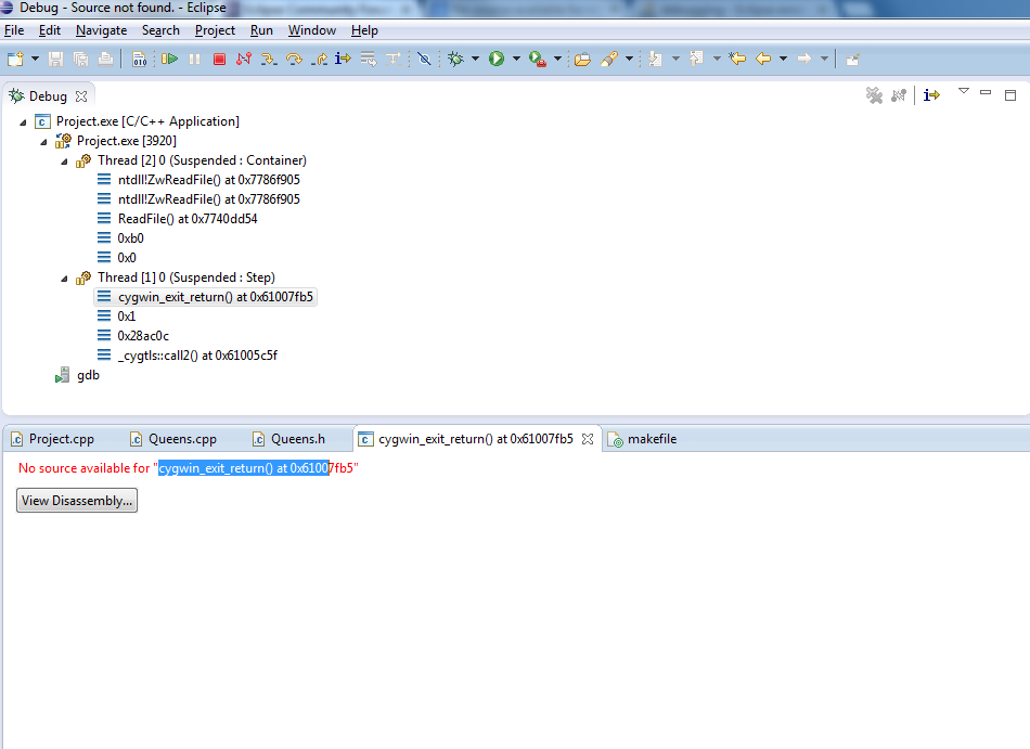

Though the next issue I am running into is being not able to Debugger perspective is not able. When I run the program as Debug, it launches Debug perspective but than I see message "No source available for "ntdll!ZwReadFile() at 0x7786f905" and due to this breakpoints and stepping through code in Debugger perspective is not operational at present. Will try to look around for this issue. In case if you know how to resolve pls let me know.
Thnxs
Update: The above problem "No source available for "ntdll!ZwReadFile() at 0x7786f905" went away. Had to clean Debug Configuration. Deleted the earlier generated listing of Project.exe and performed clean build again and this time it went fine. Only issue was during exit, it seems its displaying the message as below. Not sure if that's an issue or not.
