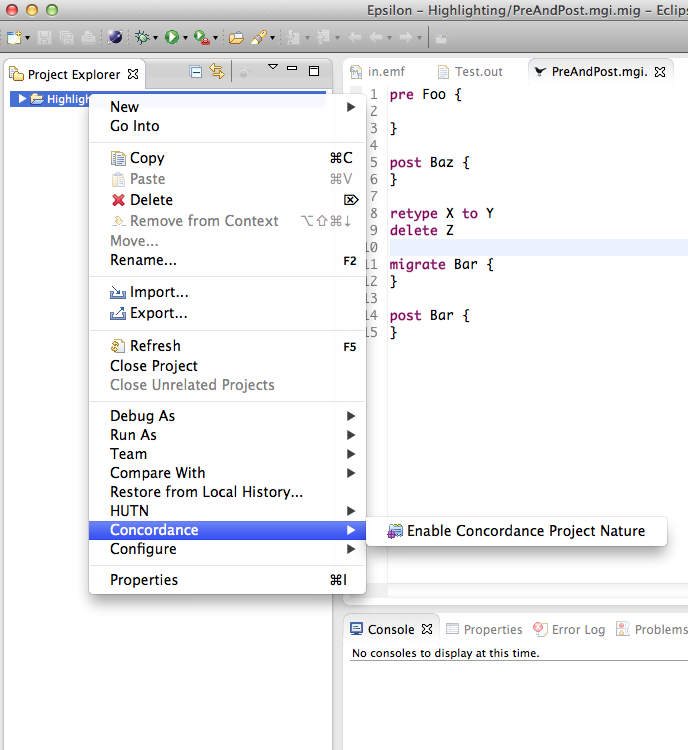

Is there an example on how to add the concordance nature to a project? I noticed the ToggleConcordanceNatureAction, but I did not find a part of the UI that allows me to try it on a project...
[/list]
If you right-click on a project, you should be able to select Concordance > Enable Concordance Project Nature, as shown in the attached screenshot.
Hope that helps!
Heh.. I does not work for Java projects, so I tried it on the wrong project... On a generic project it indeed shows in the menu.
