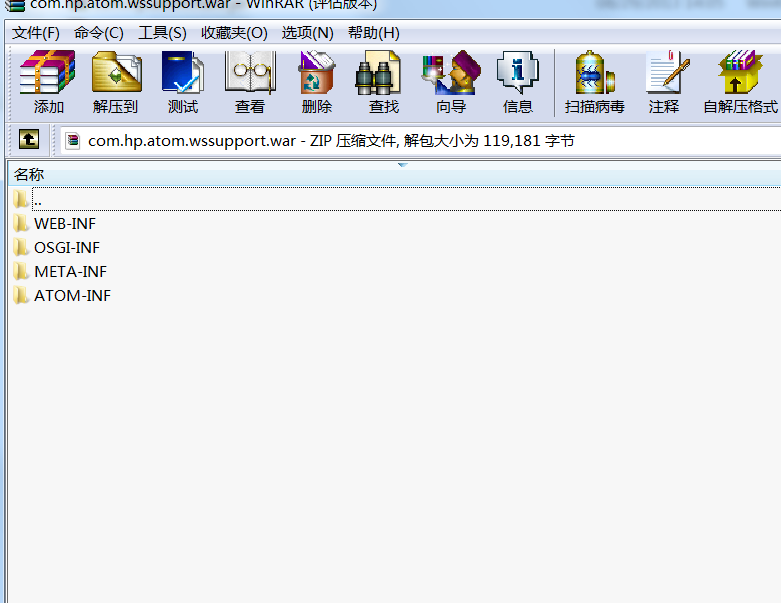

the wssupport bundle's infomation as following:
osgi> b 175
com.hp.atom.wssupport_3.1.0.SNAPSHOT [175]
Id=175, Status=RESOLVED Data Root=C:\virgo-tomcat-server-3.6.2\work\org.eclipse.osgi\bundles\175\data
"No registered services."
No services in use.
Exported packages
com.hp.atom.wssupport.i18n; version="0.0.0"[exported]
Imported packages
javax.ws.rs; version="1.1.1"<org.apache.servicemix.specs.jsr311-api-1.1.1_1.9.0 [240]>
org.apache.cxf.jaxrs.provider.aegis; version="2.6.2"<org.apache.cxf.bundle-minimal_2.6.2 [234]>
org.apache.cxf.helpers; version="2.6.2"<org.apache.cxf.bundle-minimal_2.6.2 [234]>
org.apache.cxf.interceptor.security; version="2.6.2"<org.apache.cxf.bundle-minimal_2.6.2 [234]>
org.apache.cxf.resource; version="2.6.2"<org.apache.cxf.bundle-minimal_2.6.2 [234]>
org.xml.sax; version="0.0.0"<org.eclipse.osgi_3.8.1.v20120830-144521 [0]>
org.apache.cxf.phase; version="2.6.2"<org.apache.cxf.bundle-minimal_2.6.2 [234]>
javax.servlet; version="2.6.0"<javax.servlet_3.0.0.v201112011016 [109]>
org.apache.cxf.transport.servlet; version="2.6.2"<org.apache.cxf.bundle-minimal_2.6.2 [234]>
org.apache.cxf.aegis.databinding; version="2.6.2"<org.apache.cxf.bundle-minimal_2.6.2 [234]>
org.springframework.core.io; version="3.1.0.RELEASE"<org.springframework.core_3.1.0.RELEASE [125]>
org.apache.cxf.io; version="2.6.2"<org.apache.cxf.bundle-minimal_2.6.2 [234]>
javax.xml.parsers; version="0.0.0"<org.eclipse.osgi_3.8.1.v20120830-144521 [0]>

the war bundle's structure is as following:
index.php/fa/16108/0/

it can skip this issue if I removed the fold of OSGI-INFO and ATOM-INFO.
