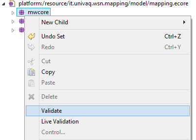

i'm extending the mwcore metamodel, creating a new one called 'mapping'. My goal is to obtain the mapping.genmodel file: it is necessary because i want the extend the default weaving panel and i need to embed artifacts previously generated. However, during the genmodel wizard, i receive an error: it is related to the validation process; in fact, i can replicate this error using the validation tool.
index.php/fa/16032/0/
if you've problem with the image, try imageshack.us/photo/my-images/22/y6kt.png/

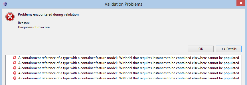

The error message is showed below: it refers to some properties of the mwcore metamodel.
index.php/fa/16033/0/
if you've problem with the image, try imageshack.us/photo/my-images/547/7dib.png/
How can i solve this problem?

Hello
did you create an extension to the mwcore metamodel?
This metamodel has only abstract elements, so it's elements cannot be directly instantiated. You need to create an element that inherits from WModel.
Marcos.
