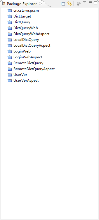

thk u for answering. i have been viewed the link and i have developed some equinox aspectj projects.the question confuse me most is if the eclipse3.x source code could be import into the eclipes workspace like an standard osgi project(as the attachment)? i have tried serveal times but all failed.
