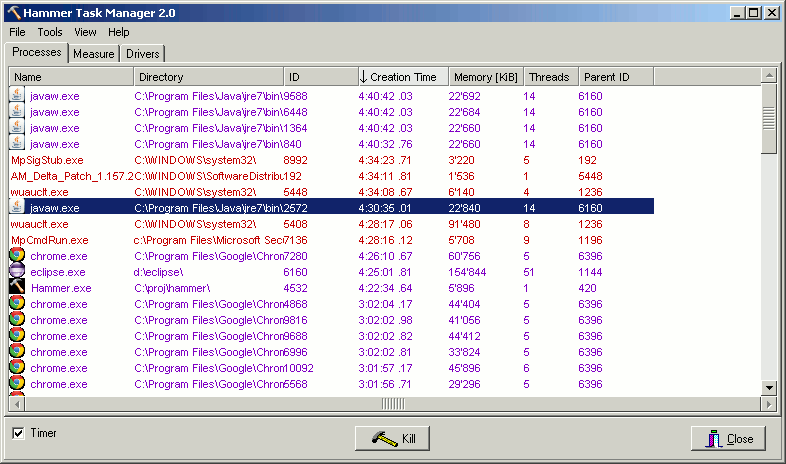

I wrote simple program. jar has only 6.8 kB. It is advantage of Java compared to Pascal, than simple programs can be very small, not megabytes.
But if I run it - it has above 20 megabytes.
The worse - if I run from Eclipse, jawaw.exe appears with 22'840 kibibytes (>20 MB) and not disappears when I terminate appliation.
Each time, I compile and run or only run application, appears new jawaw.exe with 20 megabytes memory.

Sure, at runtime your application runs in the JVM, which itself needs memory plus all the classes from JRE libraries, needed for running your program. Nothing magic.
Sounds like maybe you are closing your application window, but never terminate the application process.
