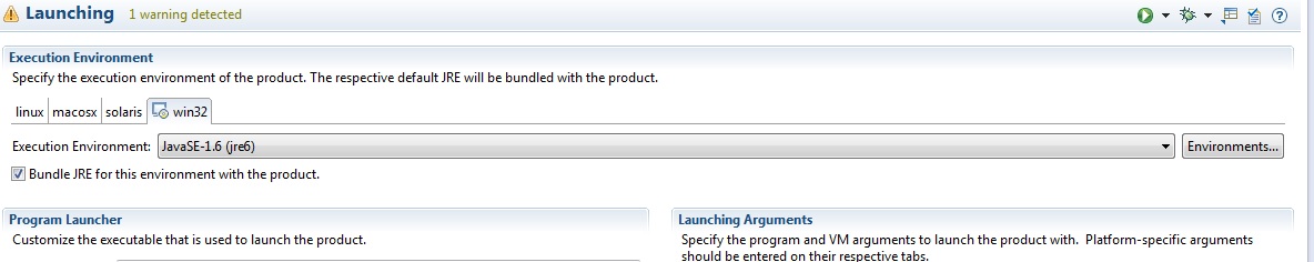

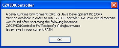

I make a test with the new export, in which I have included JRE (for this I followed the suggestions in the tutorial)index.php/fa/16111/0/,
but on this machine when run my application give me the following error
index.php/fa/16110/0/
On this machine hasn't installed any version of Java and is Win32.
My finally scope is create an export of my application that can run also if Java isn't installed on the destination machine.
I think I forgot something in some step, but I cannot figure out what.
Anyone has any suggestions to direct me on the right path to solve this problem?

Maybe the exported JRE can not be found in the exported application. Can you check that the vm path in {app}.ini points to the correct location?
-vm
jre1.6.0_35\bin\client\jvm.dll

I checked the export and contains only the following three folder:
- Configuration
- P2
- plugins
in addition to files .exe and .ini of my application and the file artifacts.xml
Should also exists the JRE folder, correct or not?
In my [app].ini are present only the following rows
-startup
plugins/org.eclipse.equinox.launcher_1.3.0.v20120522-1813.jar
--launcher.library
plugins/org.eclipse.equinox.launcher.win32.win32.x86_1.1.200.v20120913-144807
-vmargs
-Xms64m
-Xmx512m
-XX:MaxPermSize=256m
It's necessary add the row suggested by Judith, but is it necessary put them in a specific position or not?

marco giudici wrote on Thu, 05 September 2013 12:40
Yes, if you build from Eclipse/PDE you should have the JRE in a folder.
if your JRE is a "jre/" folder (near to yourapp.exe) it should be found automatically.
Specifing the path to a JRE helps the eclipse launcher to find it.
See: FAQ How do I run Eclipse? The same mechanism apply to your application.
Related topic:
* Bundle JRE along with your Product using Tycho.
* Including a JRE in a Tycho build
(From what I understood you do not use maven and tycho. Anyway it is usefull information).

Hi Jeremie,
thanks for your suggestions. I start with the first link that you suggest and I find immediately the first problem.
In this FAQ is reported the follow structure of the eclipse folder:
eclipse/
      features/			''the directory containing Eclipse features''
      plugins/			''the directory containing Eclipse plugins''
      eclipse.exe		''platform executable''
      eclipse.ini
      eclipsec.exe              ''(windows only) console executable''
      epl-v10.html		''the EPL license''
       jre/			''the JRE to run Eclipse with''
      notice.html
      readme
I check my structure and I discovered that is missing the JRE folder under the root folder "eclipse", for the moment the search of this folder didn't give result on my machine.
I think that this is the source of my problem?
