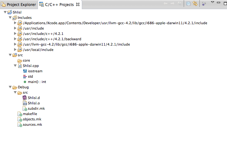

Thanks for the answer. However, I don't have a project.pro file. I attach an image of my working repertory.
Re: How to integrate Qt framework? [message #1091199 is a reply to message #1090822] Wed, 21 August 2013 03:01 Go to previous messageGo to next message
Well, you have to create the .pro file. Please refer to the Qt documentation
http://doc.qt.digia.com/4.7/qmake-manual.html
As a first step you can create a .pro file by calling
qmake -project
in your source folder.
