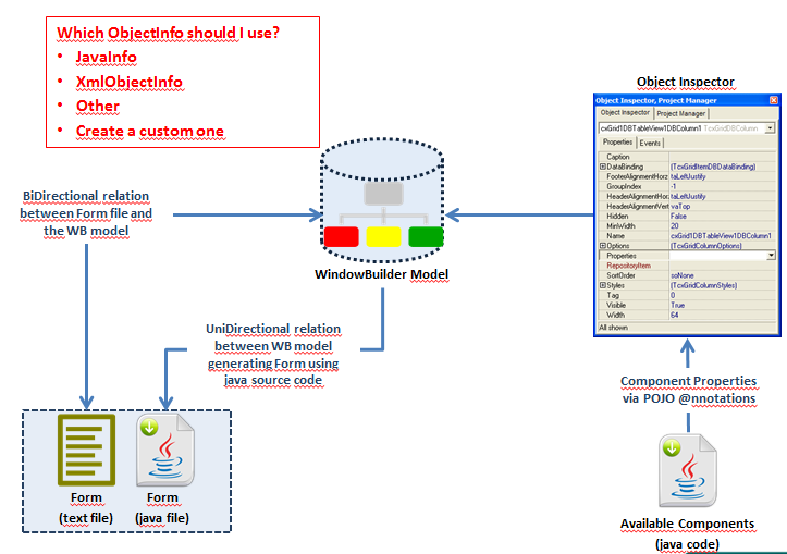

Attached there is a file describing what we are trying to do.
Some frequently questions:
- Why do not use the form.java itself instead of a form text file?
The UI toolkit was designed "couple" years ago, and that is how it works.
- Why the components are in java and not a "xml-based" file format?
The UI toolkit was designed to have the information in the source code.

I think you need something like it is done in GWT Designer (I think it is also open source).
Basically, you need to create separate hierarchy from Object, like FormObjectInfo with its own mechanism to parse, update properties, etc. Something like it is done for XmlObjectInfo, but with different implementation.
So, may be best approach is to take XML plugins, clone them and massage.
This will also solve your problem with reparsing on FRM file change.
You will have your own mechanisms for this.
As for Java file updates, you may do this manually or create only org.eclipse.wb.internal.core.utils.ast.AstEditor to update it.
