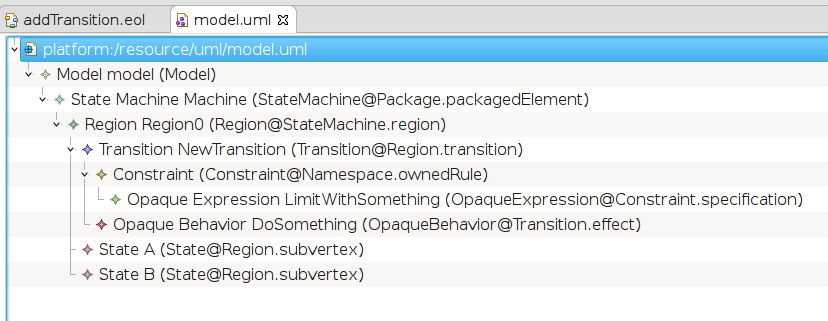

Normally, when I need to transform a model in a particular way, the quickest way to find out the code I need to write is to use the regular model editors to do it manually, and then use the Exeed model editor to find out exactly which types I have to use and which attributes and structural features I need to change. For that, the "Show Structural Info" in the Exeed menu of the Exeed editor is really useful (screenshot attached).
This is usually faster than looking at the EPackage Registry view, especially with complex metamodels such as UML. With all this information, I only have to write the appropriate EOL code and then use it from the EWL wizard.
Anyway, I went ahead and created manually a model with a transition, and then wrote a simple EOL fragment that will add a transition from A to B with an OpaqueExpression as guard and an OpaqueBehavior as effect. I hope you can use it as a reference Smile.
