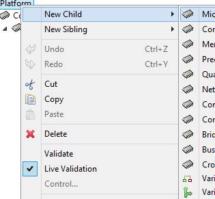

The Creation Sub-menus property is set to true but it doesn't work as you can see in the attached image.
  • Attachment: submenu.jpg
    (Size: 16.19KB, Downloaded 219 times)
Re: Genmodel property "Creation sub-menus" [message #1094732 is a reply to message #1094387] Mon, 26 August 2013 01:42 Go to previous messageGo to next message
Re: Genmodel property &amp;amp;amp;quot;Creation sub-menus&amp;amp;amp;quot; [message #1095068 is a reply to message #1094732] Mon, 26 August 2013 11:24 Go to previous messageGo to next message
Hi Ed,
changing the plugin.properties to:
_UI_CreateChild_text = {1} | {0}
_UI_CreateChild_text2 = {1} | {0}
_UI_CreateChild_text3 = {1} | {0}
hasn't any impact on the menu I mentioned before. There is no submenu although the elements are intances of the same class. Whereas items where I haven't customized the getText method seems to have now an additional submenu (which I don't want btw):
index.php/fa/16041/0/
Unfortunately I couldn't found the method you mentioned using Ctrl-Shift-T.
I don't really understand how the submenu are working, so it's hard for me to find a solution
    (Size: 8.25KB, Downloaded 592 times)

yes I've found that class and the extractSubmenuActions(Collection<IAction>) is every time called except for the one wich has got more than one child instance of the same class. That's weird for me as I can't explain this behaviour. I customized the collectNewChildDescriptors method of this item provider, so that's maybe causing this?
The default one generated looks in my case:
_UI_CreateChild_text = {0}
changing _UI_CreateChild_text to {1} | {0} provides submenus for all childs except the one I mentioned.

That has done the trick, tx Ed!!
As you can see in the attached the sub-menu has no icon. Is it possible to assign an icon to the submenu?
  • Attachment: sub-menu.jpg
    (Size: 8.99KB, Downloaded 208 times)
Re: Genmodel property &amp;amp;amp;amp;amp;amp;amp;quot;Creation sub-menus&amp;amp;amp;amp;a [message #1100014 is a reply to message #1099451] Mon, 02 September 2013 10:34 Go to previous messageGo to next message
Hi Ed,
that's what I've tried so far. It works for child entries, but for the sub-menu an icon is never displayed, no matter what the method returns.
  • Attachment: sub-menu.png
    (Size: 2.85KB, Downloaded 199 times)
Re: Genmodel property &amp;amp;amp;amp;amp;amp;amp;amp;quot;Creation sub-menus&amp;amp;amp;a [message #1100434 is a reply to message #1100014] Tue, 03 September 2013 01:42 Go to previous message
Phil,
I've never seen a submenu with icons in Eclipse. I'm not sure that's
possible. The generated code doesn't do such a thing, so you'd have to
write that yourself.
On 02/09/2013 4:34 PM, Phil H wrote:
> Hi Ed,
