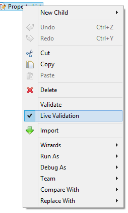

Hi everyone,
hope that this is the right forum for my Question.
I'm currently developing a EMF/GMF Editor which opens the following context menu while right clicking on elements:
index.php/fa/15818/0/
I would like to customize this by removing stuff like Wizard, Run as, Debug as and so on..This menu entries seams to appear in every explorer view.. Is there a way to remove it for the editor?
Cheers,
Phil

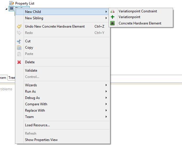

Re: customizing conext menu [message #1100720 is a reply to message #1100477] Tue, 03 September 2013 09:51 Go to previous messageGo to next message
What kind of examples do you mean? I was able to figure out how to remove some entries, but there are still entries like "run as", "debug as", "Team" and so on (see attached image).
I thought maybe commeting out "getSite().registerContextMenu(contextMenu, new UnwrappingSelectionProvider(viewer));" in createContextMenuFor(StructuredViewer viewer) would do the trick, but it hasn't changed anything.
I also checked my plugin dependencies, but couldn't find anything which could contribute this menu entries.
I don't really understand how your Jface approach should work. How can object contribution remove menu entries from ymmeditor?
  • Attachment: menus.png
    (Size: 8.50KB, Downloaded 194 times)

> stuff like "Wizards" etc., but unfortunately also the menuitem which I
> contributed in the plugin.xml isn't shown anymore.
Yes, that's to ge expected.
> Just calling getSite().registerContextMenu("myCommandId", contextMenu,
> new UnwrappingSelectionProvider(viewer)); hasn't worked.
No, the ID you use is important.
> So I thought about filtering out the unwanted contributions with this
> code:
> protected void createContextMenuFor(StructuredViewer viewer) {
> MenuManager contextMenu = new MenuManager("#PopUp") {
> @Override
> public IContributionItem[] getItems() {
> IContributionItem[] items = super.getItems();
> List<IContributionItem> filteredItems = new
> ArrayList<IContributionItem>();
> for (IContributionItem item : items) {
> if (item != null && item.getId() != null &&
> ((item.getId().startsWith("org.itea2"))))
> filteredItems.add(item);
> items = new IContributionItem[filteredItems.size()];
> return filteredItems.toArray(items);
> contextMenu.add(new Separator("additions"));
> contextMenu.setRemoveAllWhenShown(true);
> contextMenu.addMenuListener(this);
> Menu menu = contextMenu.createContextMenu(viewer.getControl());
> viewer.getControl().setMenu(menu);
> int dndOperations = DND.DROP_COPY | DND.DROP_MOVE | DND.DROP_LINK;
> Transfer[] transfers = new Transfer[] {
> LocalTransfer.getInstance() };
> viewer.addDragSupport(dndOperations, transfers, new
> ViewerDragAdapter(viewer));
> viewer.addDropSupport(dndOperations, transfers, new
> EditingDomainViewerDropAdapter(getEditingDomain(), viewer));
> This works fine for my menuitem, but it turned out that using this
> filter (it doesn't matter which sring is used in
> item.getId().startsWith("org.itea2")) results in a context menu
> without the EMF menu items like "New Child", "undo" etc.
> Is there any workaround for this?
It looks like your filter filters out pretty much everything. Are you
actually using a debugger to observe what your filter is doing?
Re: customizing conext menu [message #1104080 is a reply to message #1103691] Sat, 07 September 2013 16:57 Go to previous message
It seems that the EMF menu items have no ID, so the following has done the trick:
if ((item != null) && ((item.getId() == null) || (item.getId().startsWith("org.itea2")))) {
