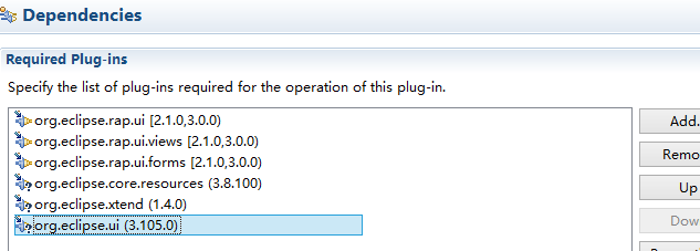

I want to use the Bundle org.eclipse.ui in RAP Application, and i know that in RAP we use org.eclipse.rap.ui instead of org.eclipse.ui, but i want to use the interface org.eclipse.ui.INewWizard in org.elcipse.ui.

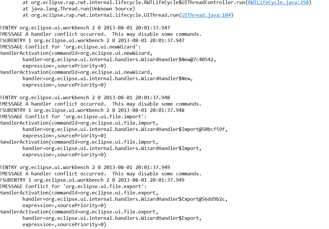

The problem is, if i add the Bundle org.eclipse.ui(option) in "Dependencies" like picture 1, i must do this (Run -> Run Configurations -> Bundles -> Add Required Bundles), because org.eclipse.ui need another Bundles. Then, if i click "Run", there are a lot of conflicts between Bundles like picture 2.

Re: Bundles Problem in RAP [message #1078595 is a reply to message #1077450] Sat, 03 August 2013 04:01 Go to previous message
It seems that you try to run some IDE-bundles like
org.eclipse.core.resources with RAP. Unfortunately, this is currently
not supported.
If you included these bundles by accident, there's a list of the
required bundles in the developer's guide [1] together with some
explanation.
Ralf
[1]
http://eclipse.org/rap/developers-guide/devguide.php?topic=launcher.html&version=2.1
Ralf Sternberg
Twitter: @EclipseRAP
