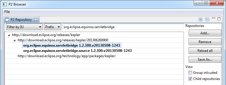

I got an answer from Ken:
The jar is available on the Kepler P2 Update site:
http://download.eclipse.org/releases/kepler
There is no direct URL, but an easy way to download the jar is to use the P2 Browser application.
index.php/fa/15785/0/
